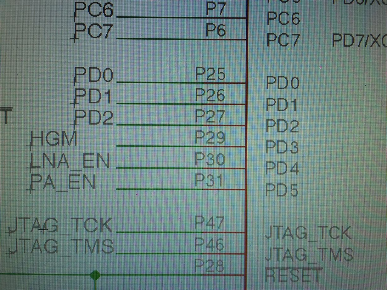

  • In the question 5, you said that is no full flexibility, I have a custom cc2538, but I didn't respected the reference design, Is there anything that I could do?
    Here is a image of my design, the part of the RF.
  • PA_EN and LNA_EN can only connect to PCx pins. I think you have to revise your schematic to make it work.
