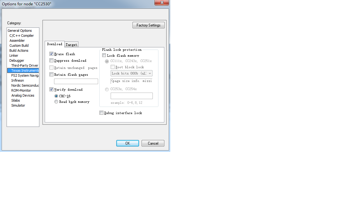

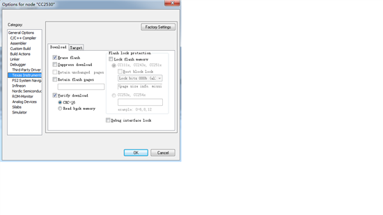

  • lock at this picture:

  • Is your SmarRF05EB+CC2530EM powered by battery or USB?
