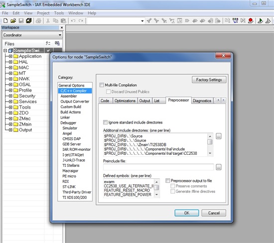

    as u suggested i did the same thing i created the new workspace in my another pc drive and then i created a new project files in that and then all the source file listed in sample light application i copied all the sources file in a folder then in IAR i created 2 group (application -> in this group i added source file of sample light application and source group->in this i added all the header and soucre files and i created one tools group also in that i added all the files listed in tools group of sample light...) then i replicate all configuration setting given in option tab as it is in my project... i also gave path name for library files listed in sample light project but i am facing few problems ->
    1) As in sample light i can select co-ordinator, enddevice or router under workspace tab but in my project i amnot able to do this only debug and release option is coming there..so plz tell me how can i get co-ordinator, enddevice or router option under workspace tab..
    2) i included all the files but still i am getting error saying-
    Error[Pe147]: declaration is incompatible with "__interwork __softfp uint8 SSP_CCM_Encrypt(uint8, unsigned char *, unsigned char *, uint16, unsigned char *, unsigned C:\Users\Maneesh\Desktop\My_IAR_test_project\new_source\hal_ccm.c 124
    char *)" (declared at line 44 of "C:\Users\Maneesh\Desktop\My_IAR_test_project\new_source\hal_ccm.h")
    Error[Pe147]: declaration is incompatible with "__interwork __softfp uint8 SSP_CCM_Decrypt(uint8, unsigned char *, unsigned char *, uint16, unsigned char *, unsigned C:\Users\Maneesh\Desktop\My_IAR_test_project\new_source\hal_ccm.c 130
    char *)" (declared at line 45 of "C:\Users\Maneesh\Desktop\My_IAR_test_project\new_source\hal_ccm.h")
    Fatal Error[Pe1696]: cannot open source file "ZComDef.h" C:\Users\Maneesh\Desktop\My_IAR_test_project\Source\OSAL_SampleLight.c 45
    searched: "C:\Users\Maneesh\Desktop\My_IAR_test_project\Source\"
    searched: "C:\Program Files (x86)\IAR Systems\Embedded Workbench 7.0\arm\inc\"
    searched: "C:\Program Files (x86)\IAR Systems\Embedded Workbench 7.0\arm\inc\c\"
    Fatal Error[Pe1696]: cannot open source file "ZComDef.h" C:\Users\Maneesh\Desktop\My_IAR_test_project\Source\zcl_samplelight.c 36
    Fatal Error[Pe1696]: cannot open source file "ZComDef.h" C:\Users\Maneesh\Desktop\My_IAR_test_project\Source\zcl_samplelight_data.c 44
    even though i included ZComDef.h file under the source group of my project but still it is giving error.. i dont understand why???
    and compatibility issue was not in original sample light project but why it is coming in my project i i dont understand??? i included all the files given in sample light project and i did all the setting as it is....
    so sir will you plz help me in sorting out all these error so that i can compile my project properly.....plz help me... thank you....

  • Hi Maneesh,
    Please make sure include paths are set ok. Snapshot attached
    Saurabh
