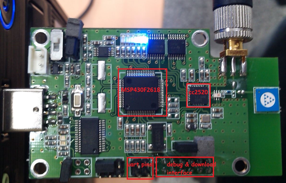

What is wrong ? why do I get positive value of the 8 bit integer. I am displaying in signed format.
I am extracting the rssi value from this received packet:

  • Do you have an option to debug what the other side (cc2520) sends to the serial port?
    It seems to me like some sort of overflowing on the cc2520 side when you sending this number to the serial port
  • Well This is my device, which side do you mean ? at the moment I am using the uart pins section (in image).
    I am using sampleApp and in SampleApp code, I configure the uart port then I give HALUARTWRITE commands.
    first to send ID.
    then RSSI value.
    then LQI value.
    so all are in order in my realterm output:
    ID RSSI LQI all three in order.
    Each is one character long.
    So I am not able to understand how can it be overflowing ?

  • Do you have an option of debugging the FW running on MSP?
    In case you have such an option, you could trace whether the wrong RSSI values are transferred from cc2520 to MSP, or the wrong values are transmitted from MSP to the serial on your PC.

  • Sir,
    I think I solved my problem.
    Sorry to bother you this much.
    void SampleApp_MessageMSGCB( afIncomingMSGPacket_t *pkt )
    unsigned char* Recv_RSSI = (unsigned char*)&pkt->rssi;
    HalUARTWrite ( HAL_UART_PORT_0, Recv_RSSI, 1 );
    I was printing values at the address ( equals to rssi).
    Now I am printing the rssi values and they are like this, I guess these looks correct:
    These values are when both the zigbees are near. does they look correct ?
  • Nice to hear it working well finally. It looks good.
