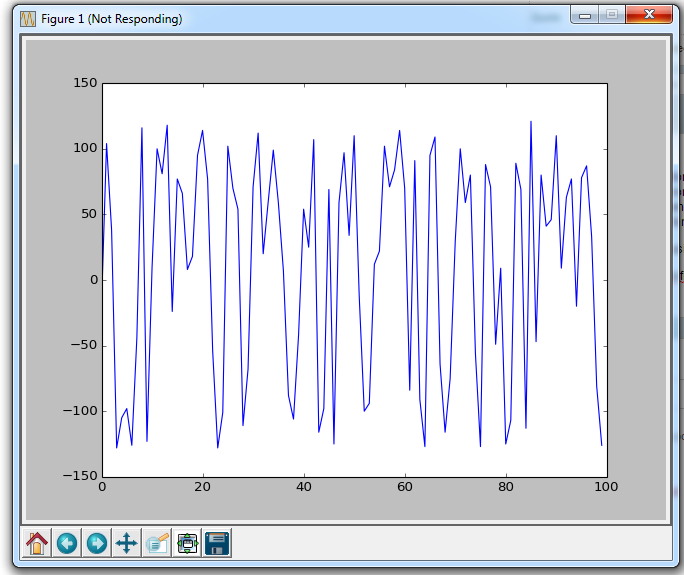

i am using TIMAC protocol stack  for sensor data transfer.now i want to send a sine wave generated by the function generator at the transmitter side and display the sine graph on the monitor attached at  the receiver side by using python language.
i will be using the same pins to transmit the sine wave components as that for the sensor data.I am i correct in my approach.
plz suggest .thank you.
    Please give more setup details : h/w etc. Do you want to  transmit un-modulated carrier wave on TI device or have external function generator connected to it's ADC pin ?
    Saurabh
  • hi ,
    I am using external function generator connected to ADC pin.I am sending the ADC code also.plz check and tell whether it is correct or wrong.actually i want to send an accelerometer sensor signal of the range (0.15hz to 1000 hz).what sampling frequency can i set to get correct output.I want to check the proper working of ADC so i am checking it with external function generator by giving input sine of 20hz and settings frequency 226.9hz.
    i am seeing the display using python plotting.i am attaching the snap shot of the plot also.plz check .

    I am using MSP430F5438A controller, I want to know that if it is possible to test ADC values on receiver side using DAC12_A. Please tell us a method how to test sine signal from generator.
