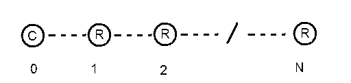

are there restrictions on number of routers using ZigBee Pro and cc2530?
Do I have to worry about RAM size?
I want to create a network like this:

  • Hi Genzi,
    the latest Z-Stack Version (2.3.0) has a source routing API integrated. With this new APIO you get a callback for each incoming route record packet by registering for ZDO_SRC_RTG_IND. This allows you to store this information whereever you want since it is possible to transmit the data with "AF_DataRequestSrcRtg" and a pointer to your stored relay list. So the only limiting factor is the packet itself. Every relay entry is two bytes long.
    Hope this helps.
    Tobias

  • Hello again,
    I have done some research, but I would like some clarifications. Please tell me if I have understood something wrong :)
    I have a gateway (or something similar) which is used to manage the network (mentioned in the previous post). Practically nothing else communicates with routers (e.g. no router-to-router unicasts), so the best method is many-to-one and source routing. If I have understood right, then I face at least the following limitations:
    • Relay Count: 1 Octet
    • Limits maximum number of addresses in the relay list to 256
    • Not too bad limit. If every node could reach next two nodes (and naturally those two before), I could have about 500 nodes. And if the gateway is in the middle of the chain, there could be 1000 nodes (500 in both directions)
    • Packet size
      • Maximum packet size is 127 octets
      • After overhead there's less than 100 octets left and as Tobias said, each address takes two octets (16-bit nwk address)
      • Limits maximum number of addresses in the relay list to less than 50?
    Anything to add?
    How can I overcome those limitations? Here's two ideas:
    Fragmentation. Can I use message fragmentation? I haven't gone in to the details, but I think about relay list as overhead, and I would expect that I can't send overhead in different packets. I think I'll have to do some reading...
    "Normal" routing. I just need to have enough RAM for the routing table, but otherwise there's no "hardcoded" limitations? Using RREQ & RREP the cost field increases with each hop, but is the actual route been sent with the RREQ or RREP packet? Z-Stack Developer’s Guide: "Each of these RREQ packets will contain the total route cost along the route that it traveled." If I understand that right, then there's no route information sent with the packet, but just the link cost of the route taken? It would be "along with" if the route would also be included? English is not my first language, so it's better to make sure ;)
    I have been pondering these questions today and I'm starting to feel more and more confused, but I think that's normal. More coffee...
    -Lasse
  • Good morning,
    you can forget fragmentation + source routing. Each of the fragmented parts of the packet needs its own complete relay list to find the destination.
    Normal AODV routing should work (theoretically) I think. If you only have one destination you could perhaps set the timeout value for your routes to 0 and therby deactivate route expiry. Than perhaps the route reqeust procedure is only called once and each node knwos how to route the packets to the concentrator.. Possible, I think.
