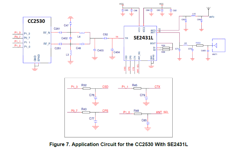

CC2530 and SE2431L P1_0 issue
Do you know if P1_0 is redefined anywhere in the code and set to tristate?  Currently my customer has  P1_0 set as the output and pulled low which it is supposed to be. But he has his ANT_SEL working incorrectly and selecting
Antenna 2 instead of Antenna 1.
Out GPIO usage for the SEL2431 is exactly as the reference design (P1_0 for the antenna select) and we are noticing an interesting issue with this GPIO.  When we measure it with a meter or a scope we see this bit is at 0V but the Skyworks is incorrectly sending the RF out the Antenna 2 port!  If we physically pull this GPIO to 0V the Skyworks will correctly send the RF out the Antenna 1 port.
