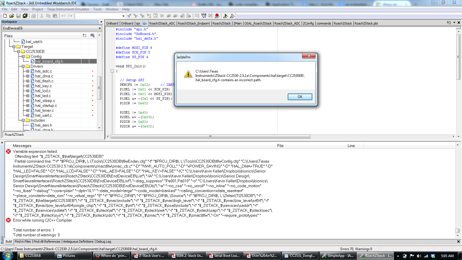

I have inherited a project using the smartRF05EB with a CC2530EM mounted. I also have a cc2531 USB Dongle that should communicate with the smartRF board.
I can compile the demo code in cc2530_development_kit_user_guide and flashed it to the smartrf device. And it worked without issues. I have not tried to get the cc2531 dongle to work yet.
I then tried to open the code that my predecessor in the lab wrote and it will not compile. I know for certain that it works, but it just will not compile on my machine.
The goal of the project is to use the cc2531 Usb dongle to communicate over zigbee to the cc2530 to control a pcb. It was a senior design project last year but was never fully completed.
I presume there is an issue with the compiler and/or linker settings. I have attached a screen shot with the error. I also get an error when trying to open the hal files.

  • I have installed version 8.10.4 and 8.10.3. I have tried the exact code on a computer with version 8.30.2 and it works fine and with the 8.10.* version I get issues about the files being created on a new version. And they were created on version 8.30.2
    I have version 8.30.3 installed at the moment. The current issue is it is not able to find the files even though I know they are there and IAR can open the file!
    I have the precompiler set to search an environmental variable set to C:/Texas Instruments\
    I have no idea why the IAR is searching through C:/Users/. I could not find where that setting was.
    I have the settings set to the following with a ZSTACK environmental variable to C:\Texas Instruments\ZStack-CC2530-2.5.1a\Components

    Fatal Error[Pe1696]: cannot open source file "OSAL.h" C:\Users\Texas Instruments\ZStack-CC2530-2.5.1a\Components\stack\af\AF.c 44
                searched: "C:\Users\Texas Instruments\ZStack-CC2530-2.5.1a\Components\stack\af\"
                searched: "C:\Users\Kevin Keller\Dropbox\ibionics\Testing\SmartNeuralInterfaces\RoachZStack\CC2530DB\"
                searched: "C:\Users\Kevin Keller\Dropbox\ibionics\Testing\SmartNeuralInterfaces\RoachZStack\CC2530DB\..\Source\"
                searched: "C:\Users\Kevin Keller\Dropbox\ibionics\Testing\SmartNeuralInterfaces\RoachZStack\CC2530DB\..\..\ZMain\TI2530DB\"
                searched: " C:\Texas Instruments\ZStack-CC2530-2.5.1a\Components\"

  • Ok. We are a bit closer to getting this issue resolved, but I still have unexplained behavior.
    I have two identical projects. One in C:\Texas Instruments\ZStack-CC2530-2.5.1a\Projects and one on my desktop.

    If I use your suggestion with the $PROJ_DIR$\..\..\..\..\..\Components\hal\include, it works with the one in \Projects but not with the desktop one.
    If I hardcode C:\Texas Instruments\ZStack-CC2530-2.5.1a\Components\hal\include it works with both.
    My issue is, I have an environmental variable for my machine. ZSTACK that I have set to  C:\Texas Instruments\ZStack-CC2530-2.5.1a\Components
    I don't see the difference between the hardcoded version and the version using the ZSTACK, yet only one works. And if you look at the error output, it is looking in the proper folder!
    Why am I getting this behavior? Is there any way of making it work with the ZSTACK variable?

  • Here's the thing. It is pulling NOTHING from the ZSTACK variable. But in the error message (see previous post attached file), it says it is looking through the folders for the files.
    I only have the Project folder on the desktop.
    I tried removing all references to the ZSTACK and hardcoding the path into the precompiler, but it gave the exact same error on Dropbox and Desktop. I then tried removing ZSTACK and replacing it with $PROJ_DIR$, and it fails for Dropbox and Desktop.
    If the project is in \Projects it works to hard code it or use $PROJ_DIR$.
    Is there any workaround outside of using \Projects for everything?

  • Looking back a couple of days, I notice something interesting in error text line: '...searched: " C:\Texas Instruments\ZStack-CC2530-2.5.1a\Components\hal\include\"...'
    The first character of the pathname appears to be a space - I suspect that your PC does not have a drive " C:"
    Perhaps your string for the $_ZSTACK_$ environment variable has a leading space?
  • Good spot. That solved that issue. Wish I had spotted that last week, but I learned to another thing to check during troubleshooting.
