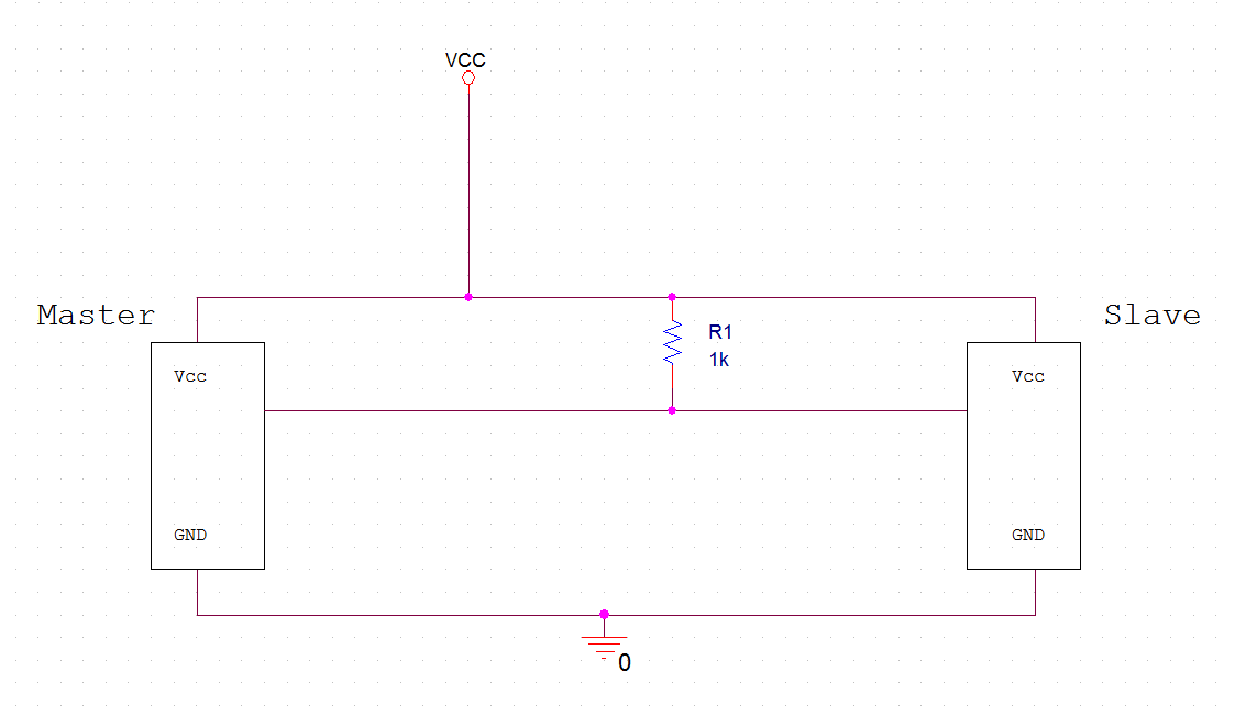

Hi all,
I'm working on implementing 1-wire bus between two CC2531 USB dongles. For that matter the first thing I am trying to work out is make one of them pull down the line to trigger an interrupt on the other dongle. That is:
-Master configuration: pin 1.4 as input, INT enabled, no pullups. By default the input will be high, until the slave pulls down the line.
-Slave configuration: pin 1.4 as output, no pullups. When I press SW1 it should put output LOW.

 I attach part of the code (what I think it is failing) and the basic setup on the protoboard.
My problem is: If I test the master individually bringing the line to GND manually, it does work, the master sees the edge and interrupts. On the other hand, the slave works individually and brings the line down putting a LOW on the output. When I mount them together it does not work.

Do you people see anything wrong?
Frankly I appreciate your help
