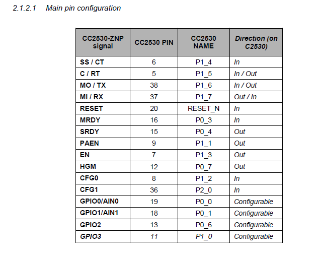

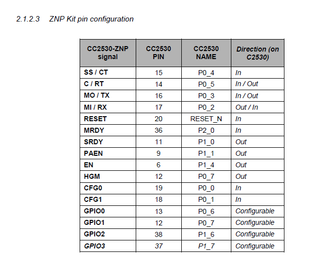

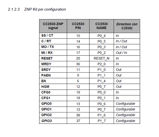

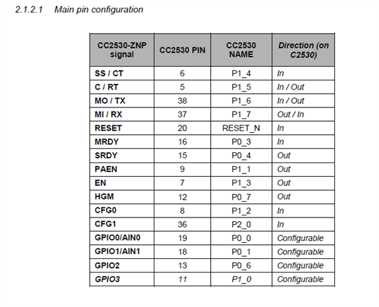

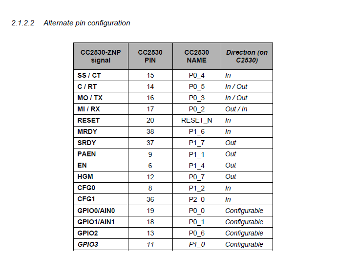

pin configuration ZNP
i found in CC2530ZNP Interface Specification pdf there are 3 tables for 3 different configuration either if i am going to use SPI or UART, which one should i use if i am going to use the already compiled images that comes with the Zstack???

  • ok thanks so much, how about the right hardware configuration that i should use, shall i use the main configuration or the alternate configuration or the ZNP kit?
  • What do you mean main configuration or the alternate configuration? I know ZNP kit but What is main configuration and the alternate configuration?
  • If you make P2_0 (CFG1) high, it will use main pin configuration which communication would go through SPI.Otherwise, if you make P2_0 (CFG1) low, it will use alternative pin configuration which communication would go through UART.
