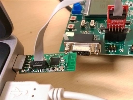

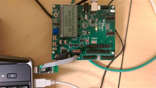

  • Hi David,
    To reflash the CC2531 usb dongles using the SmartRF05 board you will have to do the following steps:
    -Plug in the SmartRF05 board and the CC2531 usb dongle to the computer and to each other as shown in the pictures bellow.
    -Now you can flash the usb dongle using IAR or Texas Instruments SmartRF Flash Programmer
    -If you are using IAR, open the project that you wish to flash into the dongle and press CTRL+D or go to the menu Project->Download and Debug
    -When using SmartRF Flash Programmer, select the image that you want to flash into the dongle in the box that says Flash image:.
    Then select Erase,program and verify, in the Actions box and finally click in the Perform actions button.
    If the dongle is succesfully flashed, the program should display
    CC2531 - ID9740: Erase, program and verify OK
    in the text box below the Perform action button.
