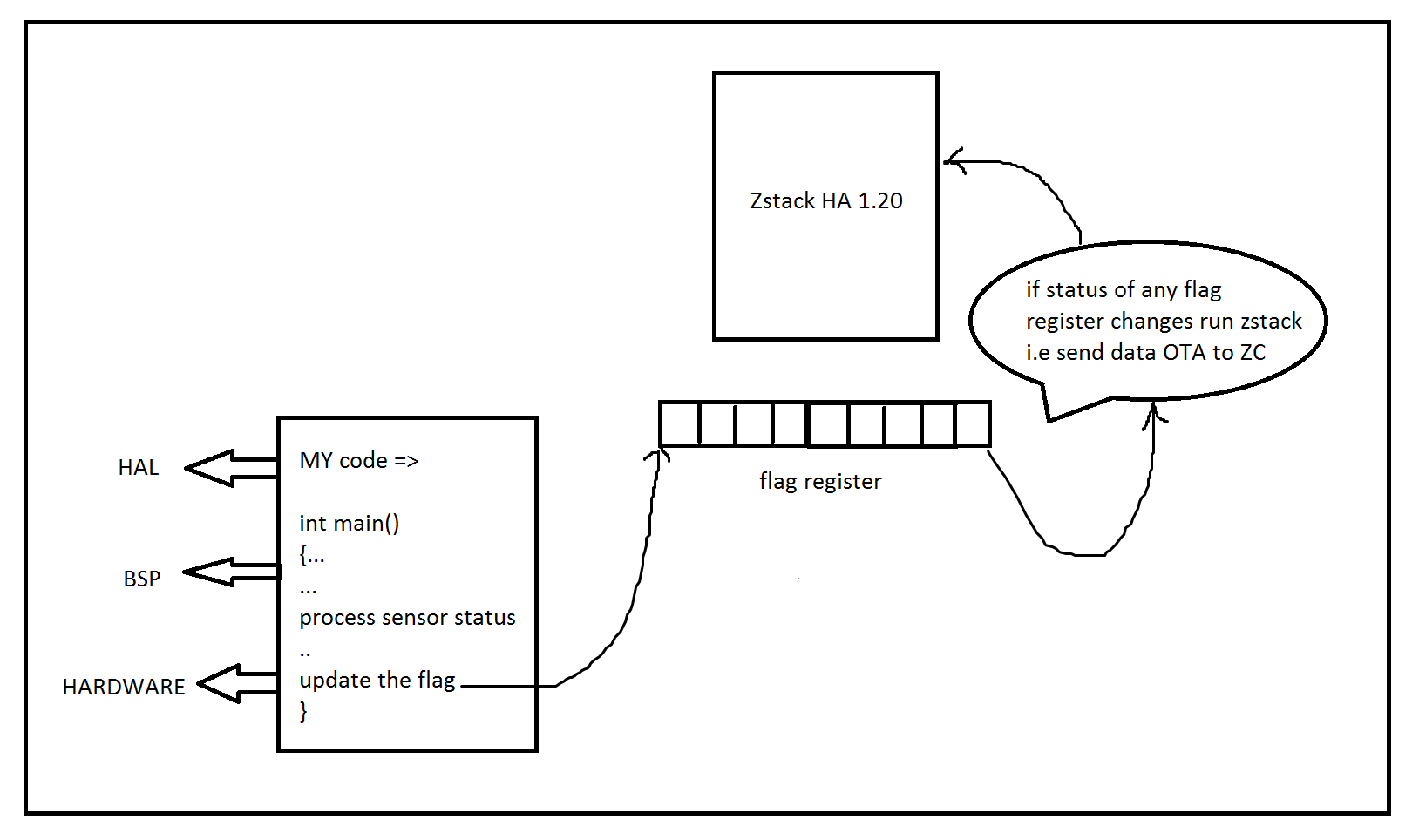

i want to implement something like this -> ( plz refer attached pic for more clarity )
1) i hav my application code with main() and in that under while(1) loop i am monitoring my sensors data and processing it..... for ex -
int main()
      while(1)
      process sensors data...
      update the bits in flag register
   return 0;
this application is for cc2538 only and i implemented this using cc2538 foundation firmware code..my this application is making use of HAL, BSP and driverlib provided in that codes
2) in this application i am creating one flag register and as per the sensors status i am modifying this flag register.
3) now what i want is that -> zigbee should periodically monitor status of my this flag register and  as soon as if any change is happened zstack should run ISR related to that bit and should start the n/w and send report to ZC over the air....
4) after sending the report zstack must monitor the flag register statud and if any further changes happening then must inform the ZC....
5) i dont want to register my main code in task array of zigbee like generally we are doing.....
6) zigbee is like a ISR for me whenever my flag bit is sent it will take my flag data and sent OTA and again return control to my main code....

  • You can't put a while(1) in Z-Stack. It will block everything.

  • The while(1) in osal_start_system is the only allowable while(1) in Z-ZStack because it is the kernel of Z-ZStack tiny os.  You can try to put your application in this while(1) but it is dangerous to have another while(1).

  • If you put while(1) in my_flag_reg_task_Init(), your application will never go out of my_flag_reg_task_Init().

  • I have advise you not to use while(1) from beginning. You should use osal_start_timerEX to create periodic event to check your sensor status and send message by Z-stack. Why do you insist in using while(1) loop?
