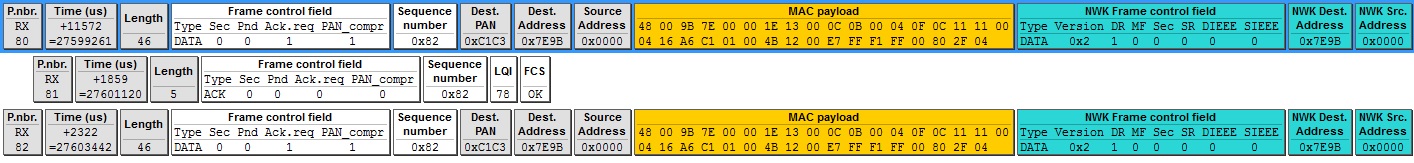

Duplicated transmitted frame problem
Other Parts Discussed in Thread: Z-STACK, CC2530
I use CC2530 with Z-stack 2.5 to transmit a frame. But  sometimes I fund the transmitter will send multiple same frames to same destination even if the ACK has been received.  Can anyone help to find what is the problem?
