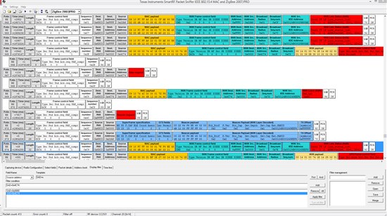

I am testing my network and see that a ZED will be issued a NWK Leave from its parent (ZC) after over an hour or more of running well, but I don't know why.
I am using Home 1.2.1 on a CC2530 with ZIGBEE_CHILD_AGING defined and set up. I have not seen this before and cannot understand why this would occur.
ZDO_MGMT_LEAVE_REQUEST is not defined nor do I attempt to issue a leave request anywhere in my application.
Security is off, many-to-one routing is used.
Does anyone know why ZC in this case would issue a leave request?
Here is a screen shot of Packet Sniffer:
Message number 865 - 868 is the ZED working as normal, then 869 it is told to leave.

    I have uploaded a new packet sniffer file.
    My set up is very simple: one ZC, four ZED's. Each ZED transmits every minute two bytes of data and goes back to sleep. The packet sniffer log shows everything working well for 32 minutes. Then at message number 644 things start to go wrong.
    Message 649: Leave Request
    The ZED sends a message as normal but it does not receive an ACK from ZC after it sends its Data Request. So it resends a Data Request 2ms later to which it does get an ACK. However, the ZC has decided that it wants the ZED to leave and issues a Leave Request.
    One down, three to go.
    Message 1976: Leave Request
    Some 82 minutes later, another ZED is told to leave, but this time there was no missed ACK. See message 1972 which is the ZED sending its two bytes of data, it gets an ACK, sends its Data Request, gets an ACK, but then is issued a Leave Request.
    At the time of writing the remaining two ZED's are still working and on the network. All ZED's have the same firmware and are identical in hardware.
    My next job is to repeat this and try it with ZIGBEE_CHILD_AGING disabled.
    Is there a way to determine from the packet sniffer why a Leave Req was issued?
