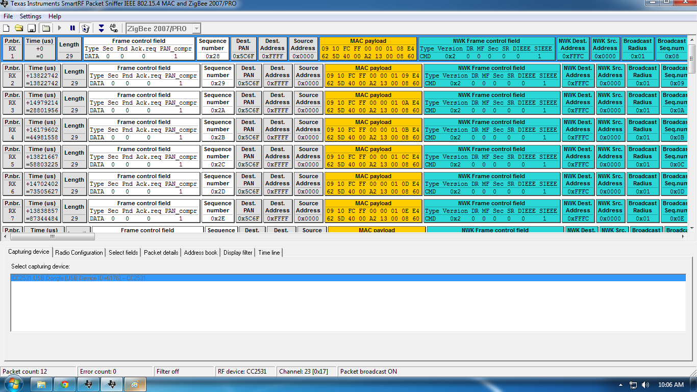

Can anyone point out what is the response to the discovery cmd from coordinator?
I referred some documents but i was not able to figure out.
I wand to communicate my end device with a gateway. But after associating, my end device cannot communicate with coordinator.  As i examined through packet sniffer, its broadcasting the discovery cmy to which i was not able to reply correctly
What does the payload in Discovery command means?
What is it actually expecting as a reply?
  • Which discovery command are you sending for the Coordinator?
    A joining device sends a Device Announce message, this happens automatically in the TI Stack (command is described in ZStack API.c - 3.1.4.20 ZDP_DeviceAnnce()). For the application on the Coord to receive this message read ZStack- Developer Guide.pdf section 6. ZDO Message Requests.
