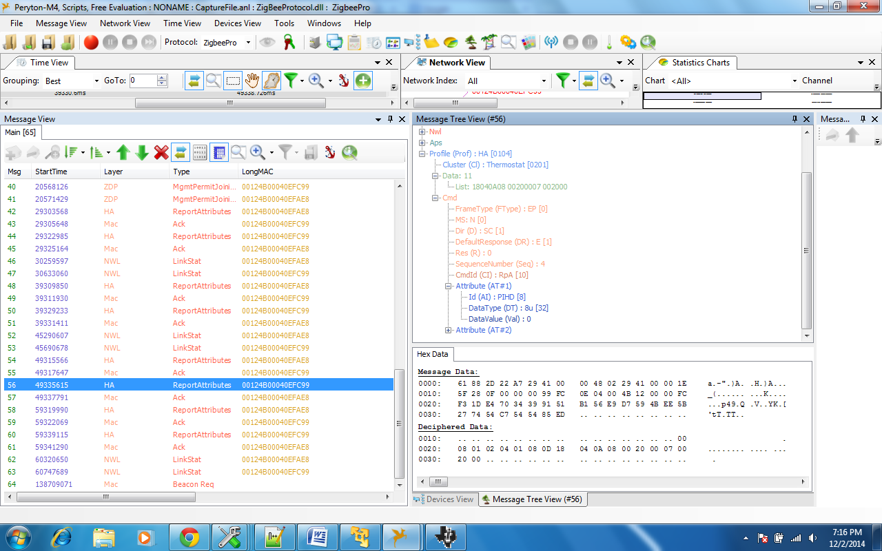

  • Do you use Ubiqua Oacket analyzer to check if the message is sent out from Sensor Temperature?
  • hello YiKai Chen sir,
    thanks for your reply...
    No i didnt check with ubique packet analyzer......
    i hav two events in my temp sensor code ->
    //sending current temp using  zcl_SendReportCmd() API
    #define SAMPLETEMPERATURESENSOR_REPORT_INTERVAL 25000
    // Send Message using AF_DataRequest() API
    #define SAMPLETEMPERATURESENSOR_SEND_MSG_TIMEOUT 10000
    so after every 25 i am sending current temp which i am able to receive at thermostat side but msg which i am sending from temp side through AF_DataRequest is not getting transmitted and i am not able to receive at thermostat side....

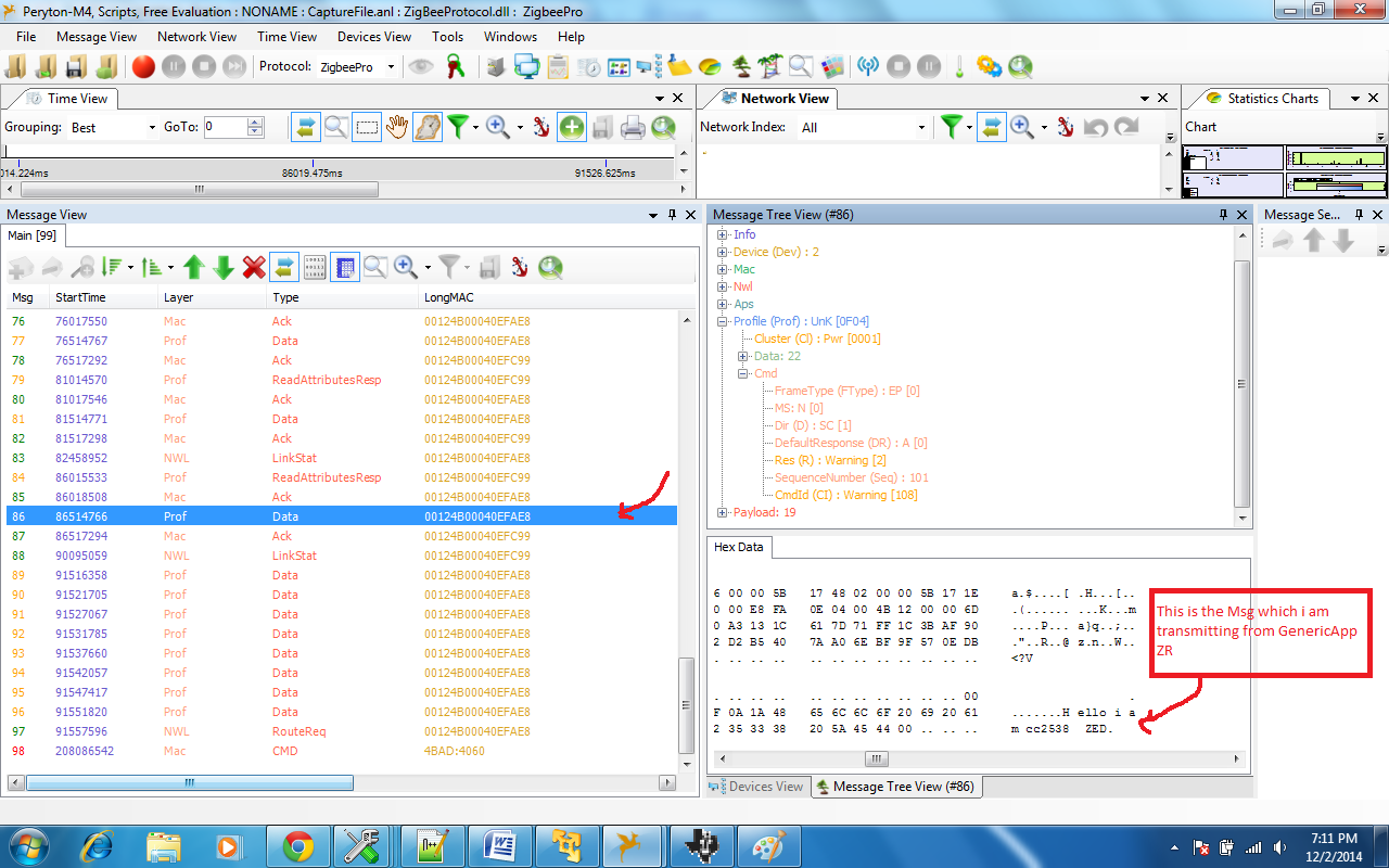

  • I see no problem you use AF_datarequest so I suggest you to use Ubiqua Packet Analyzer to have a look.
  • Hello sir,
    i checked in data packet AF_dataRequest is not sending data packet... i detected following problems ->

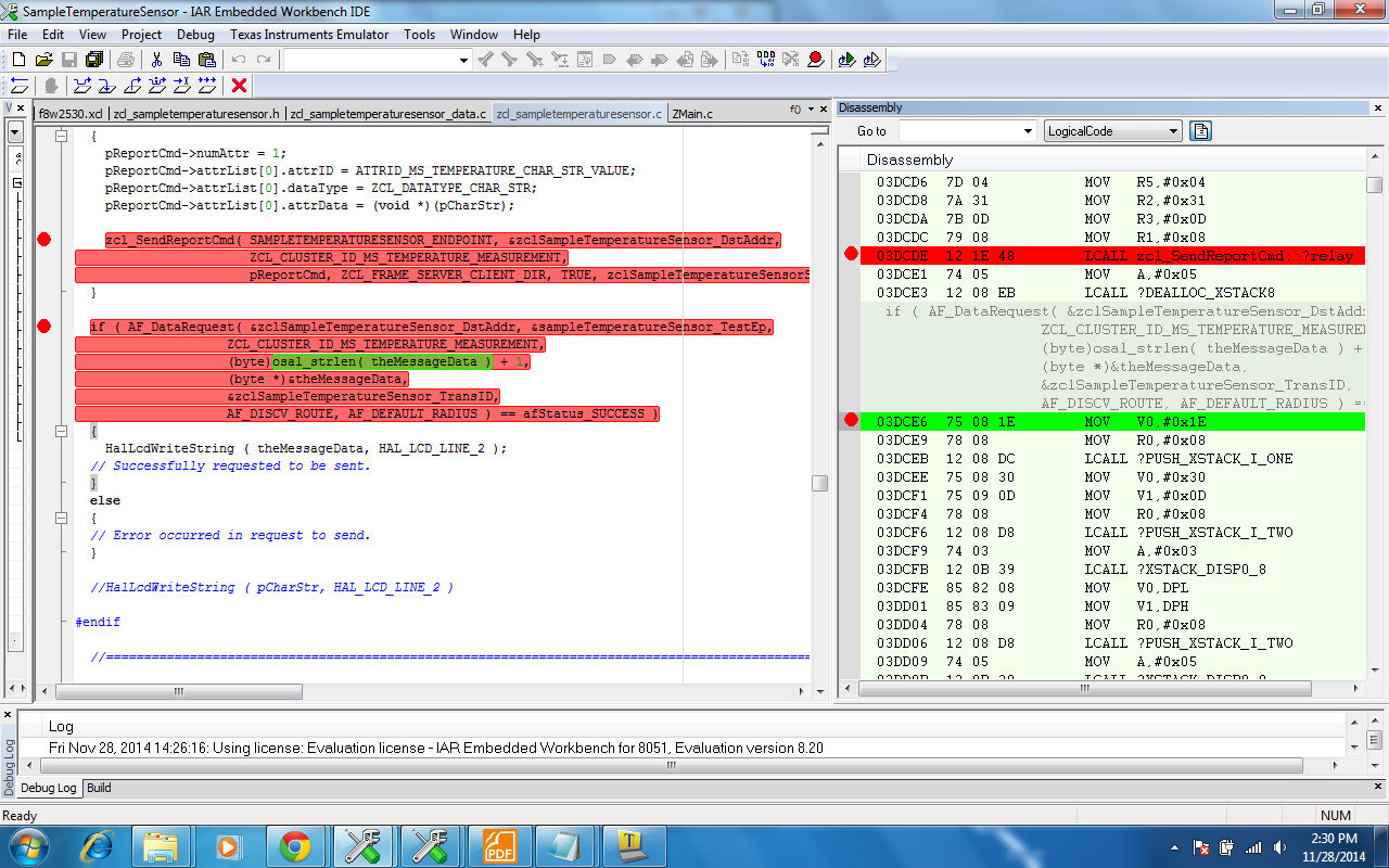

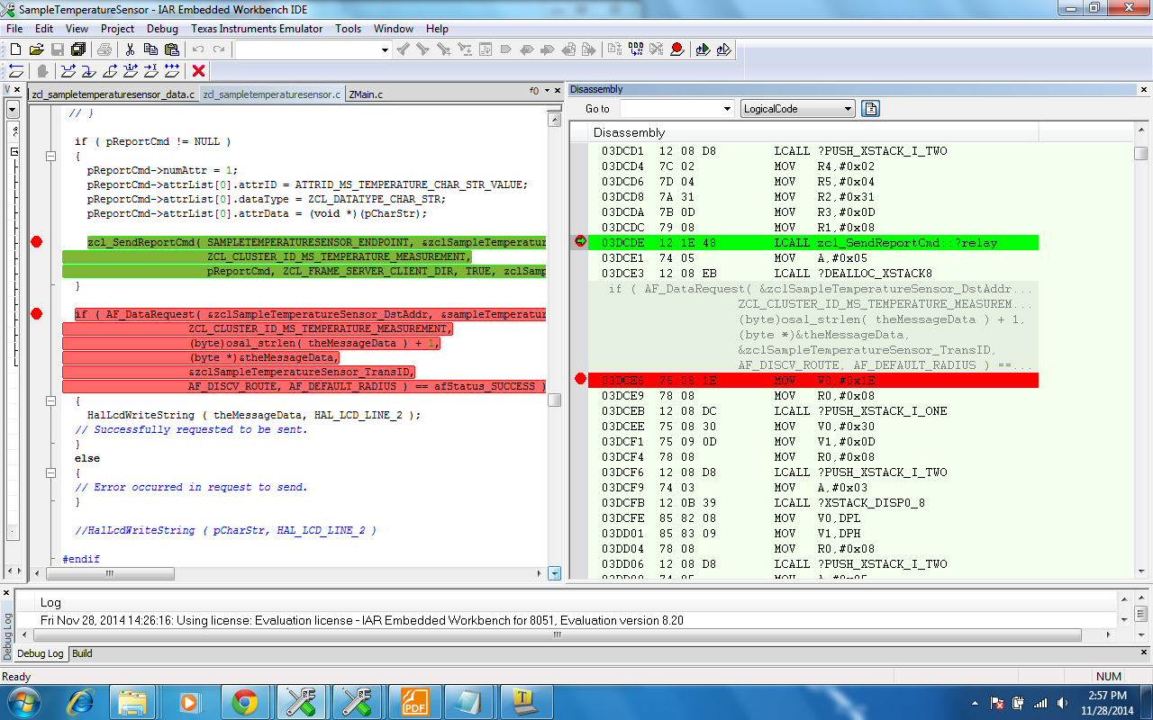

  • here is screenshot for zcl_SendReportcmd() API..... here you can see that whole API is marked in Green color but in case of AF_DataRequest only osal_strlen was marked in green.... is there any specific reason for it ?

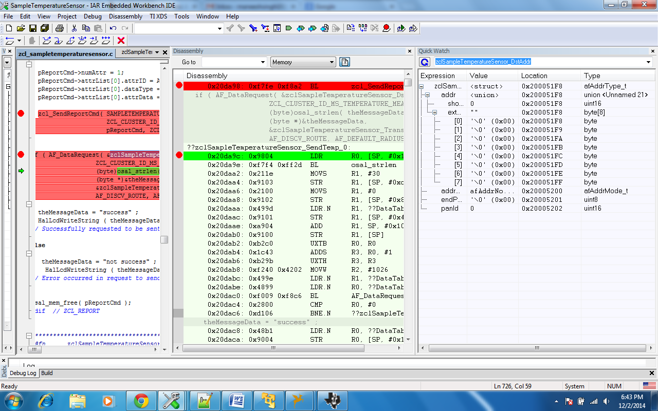

  • 1. Check return value of AF_DataRequest and see if it is afStatus_SUCCESS.
    2. Check what are in your zclSampleTemperatureSensor_DstAddr and sampleTemperatureSensor_TestEp.

    2)  zclSampleTemperatureSensor_DstAddr is afAddrType_t which is defined in AF.h file

  • I guess the problem is in zclSampleTemperatureSensor_DstAddr and sampleTemperatureSensor_TestEp. When you set the breakpoint, I suggest you to check values in clSampleTemperatureSensor_DstAddr and sampleTemperatureSensor_TestEp.
  • Hello YiKai Chen sir as u suggested i checked the values of zclSampleTemperatureSensor_DstAddr and sampleTemperatureSensor_TestEp.....
    here is the screen shot which i captured and in quick watch windows u can see the values of both--->
    plz check the above detail and tell me what is going wrong ?

  • Hello YiKai Chen Sir,
    one more thing i want share that in packet analyser i found that ->
    1) in Generic APP sample code -> it is sending the data from AF (profile)layer but
    when i tried with Temp sensor i found that there is no such packet which shows AF data is being transmitted from temp sensor.....
    so what i understand is that data is not being transmitted from Temp sensor i dont know what is the reason ? thats why in my previous post i attached my source file so that once u hav look at it if i am doing anything wrong.....
    plz sir once hav a look at my source file which i send u in previous post....plz sir..
    here is captured packet detail ->
    GenericApp which is sending Msg properly with AF_datarequest API ->
    Temp Sensor(successfully sending temp data but not sending msg by AF_DataRequest) Packet Detail ->
    NOTE :- since my Evolution Licence for Ubique Packet Analyzer is Expired so i am using another packet analyzer and sending screenshot of it......sorry for inconvenience......
    Plz hav alook at it and suggest me what i need to do to make AF_DataRequest to work.....
    plz help me sir....
    Thanks & Regards,
    Maneesh
  • In your zcl_sampletemperaturesensor.c, you can't call AF_DataRequest right after zcl_SendReportCmd. If you send message right after another immediately, the second one won't be sent. Try to remove zcl_SendReportCmd and only call AF_DataRequest.
  • hello sir,
    As u suggested i did the same ->
    in sample temp sensor in commented out the zcl_SendReportCmd like below :-
    static void zclSampleTemperatureSensor_SendTemp( void )
    /*  zcl_SendReportCmd( SAMPLETEMPERATURESENSOR_ENDPOINT, &zclSampleTemperatureSensor_DstAddr,
    ZCL_CLUSTER_ID_MS_TEMPERATURE_MEASUREMENT,
    pReportCmd, ZCL_FRAME_SERVER_CLIENT_DIR, TRUE, zclSampleTemperatureSensorSeqNum++ );  */
    if ( AF_DataRequest( &zclSampleTemperatureSensor_DstAddr, &sampleTemperatureSensor_TestEp,
    (byte)osal_strlen( theMessageData ) + 1,
    (byte *)&theMessageData,
    &zclSampleTemperatureSensor_TransID,
    AF_DISCV_ROUTE, AF_DEFAULT_RADIUS ) == afStatus_SUCCESS )
    theMessageData = "success" ;
    HalLcdWriteString ( theMessageData, HAL_LCD_LINE_4 );
    // Successfully requested to be sent.
    else
    theMessageData = "not success" ;
    // Error occurred in request to send.
    osal_mem_free( pReportCmd );
    #endif // ZCL_REPORT
    but still it is not working.... i didnt did any change in thermostat side it is same like which i send u in previous post...
    i am sending u packet detail and breakpoint data detail.....
    in this screen shot also u can see how i commented out zcl_SendReportCmd API and values of AF_DatRequest API during breakpoints....
    in temp sensor i kept breakpoint at 3 places ->
    1) in event loop at SAMPLETEMPERATURESENSOR_TEMP_SEND_EVT condition
    2) in send_temp fn at AF_dataRequest cmd
    3) at case AF_DATA_CONFIRM_CMD in eventloop
    and breakpoint is hitting all the 3 places..
    but in thermostat side i kept breakpoints at following places ->
    1) at case AF_INCOMING_MSG_CMD in event loop
    2) at af_incmoing msg callback fn i.e
    static void zclSampleThermostat_MessageMSGCB( afIncomingMSGPacket_t *pkt )
    3) at
    static void zclSampleThermostat_ProcessInReportCmd( zclIncomingMsg_t *pInMsg )  fn
    but unfortunately breakpoint is not hitting any place......
    i dont understand what is reason why temp sensor is not sending msg from AF_DataRequest
    plz help me to solve this issue sir...
    NOTE :- For sending msg from AF_DataRequest i am not doing any changes in ->
    zcl_sampletemperaturesensor.h ,  zcl_sampletemperaturesensor_Data.h and  <>osal.c file
    i am doing changes in zcl_sampletemperaturesensor.c file which i already send u in my previous post....
    the only change i am doing in <>.c file is ->
    1) in eventloop fn i added  case AF_DATA_CONFIRM_CMD and few other line (same as in GenericApp)
    2) using AF_DataRequest API in send temp fn as described u earlier and as shown in pics above....
    for receiving this msg at thermostat side i am adding only following lines in <>.c file except that i am not doing any changes in any other files... ->
    1) in event loop
    case AF_INCOMING_MSG_CMD:
    zclSampleThermostat_MessageMSGCB( MSGpkt );  //calling calback fn for priniting msg on screen
    break;
    2) and implement callback as given in GenericAPP.....
    is there any thing i am missing ? or i am not implementing ? plz help me sir....
    Waiting for ur reply.......
    Thanks and Regards,
    Maneeesh singh

  • Hello YiKai Chen sir,
    else
    3) at
    1) in event loop
    break;
    Thanks and Regards,
    Maneeesh singh
  • I don't know where your problem is. However, if I modify my sampletemperaturesensor and samplethermostat as the followings, I can send string.
    In sampletemperaturesensor, you can revise zclSampleTemperatureSensor_SendTemp().
    char *theMessageData = "Hello i am temp Sensor";
    #ifdef ZCL_REPORT
      zclReportCmd_t *pReportCmd;
      pReportCmd = osal_mem_alloc( sizeof(zclReportCmd_t) + sizeof(zclReport_t) );
      if ( pReportCmd != NULL )
        pReportCmd->numAttr = 1;
        pReportCmd->attrList[0].attrID = 0x0020;//ATTRID_MS_TEMPERATURE_MEASURED_VALUE;
        pReportCmd->attrList[0].dataType = ZCL_DATATYPE_CHAR_STR;
        pReportCmd->attrList[0].attrData = (void *)theMessageData;//(&zclSampleTemperatureSensor_MeasuredValue);
    In samplethermostat, you can revise zclSampleThermostat_ProcessInReportCmd().
    uint8 *ppp=NULL;
      zclReportCmd_t *pInTempSensorReport;
      zclReportCmd_t *pOutDemandReport;
      uint8 outDemandBuffer[sizeof( zclReportCmd_t ) + ( 2 * sizeof( zclReport_t ) )];
      bool send = TRUE;
      pInTempSensorReport = (zclReportCmd_t *)pInMsg->attrCmd;
      TclusterId=pInMsg->clusterId;
      TsrcAddr=pInMsg->srcAddr;
      TendPoint=pInMsg->endPoint;
      zclGeneral_SendOnOff_CmdToggle( TendPoint, &TsrcAddr, FALSE, 0 );
      /*if ( pInTempSensorReport->attrList[0].attrID != ATTRID_MS_TEMPERATURE_MEASURED_VALUE )
        return;
      pOutDemandReport = (zclReportCmd_t *)outDemandBuffer;
      // store the current temperature value sent over the air from temperature sensor
      zclSampleThermostat_LocalTemperature = BUILD_UINT16(pInTempSensorReport->attrList[0].attrData[0], pInTempSensorReport->attrList[0].attrData[1]);
      _dataLen = zclSampleThermostat_LocalTemperature;
      ppp=&pInTempSensorReport->attrList[0].attrData[0]; //ppp has the string!!!
  • The result on CC2530DK is attached for your reference.
    Thanks for your effort and support !!!!!!!!!
    1) if u remember in one of my previous post u only help me and guided me how to send string with zcl_sendreport  API Cmd.... and i am also able to send string properly with zcl_sendreport cmd.... (i am  also able to send int array  with this API but only upto 10-12 byte of data ).
    2) after that i asked u that i want to stream real-time audio data over the zigbee and u only suggested me  to use  AF_datarequest API cmd.... and i tested AF_datarequest API in Generic app project and i am able to transfer 70-80 byte of data successfully.....
    3) but now i want to use same AF_datarequest API in my project so that here in my project i can test transfer of data bytes and if it is successful i'll move forward and implement some logic to send audio data as suggested by you.....
    4) but now i got stuck becoz this AF_datarequest API is working fine in Generic APP but not working in my code.... for that reason i requested your help and did the changes as u suggested me but still it is not working..... reason is unknown ?
    5) i am requesting you if possible will you plz try to compile and run the source code which i am attaching here at your side and will you plz check is this working there or  what is the problem ?
    6) i did changes in only <>.c files and rest of the file is untouched so here i am sending you only <>.c file....
           GENERICAPP_CLUSTERID,   ////// here i am using my own defined cluster

  • If I revise zclSampleTemperatureSensor_SendTemp() to the followings, I don't have problem to send more than 12 bytes.
    char *theMessageData = "Hello i am temp Sensor 1 Hello i am temp Sensor 2 Hello i am temp Sensor";
    #ifdef ZCL_REPORT
        pReportCmd->attrList[0].attrID = ATTRID_MS_TEMPERATURE_MEASURED_VALUE;
    as u suggested i tried and i am able to send big string.....but this also has problem ---->
    1) when i tried to send these datatypes it works fine and i am able to receive properly at thermostat side->
    char *theMessageData = "Hello i am temp Sensor1 Hello i am temp Sensor2 Hello i am temp Sensor3";
    char *theMessageData = "123456789_123456789_123456789_123456789_123456789";
    2) but when i tried these datatypes then like my previous testing i am able to send only 10-12 byte of data maximum...
     int8 pCharStrNew[]= {1,2,3,4,5,6,7,8,9,0,0,0,1,2,3,4,5,6,7,8,9};
    char pCharStrNew[]= {1,2,3,4,5,6,7,8,9,0,0,0,1,2,3,4,5,6,7,8,9};
    at receiver side after receiving and printing 10th or 11byte data correctly i am start getting garbage values...this is same issue which i was getting before with zcl_sendreport API...
    that's why i moved to use AF_DataRequest API where i am able to send 70 -80 byte of data correctly...
    i am receiving data at receiver like this ->
    UARTprintf("received string is %d\n", (pInTempSensorReport->attrList[0].attrData[8]));  ///getting correct
    UARTprintf("received string is %d\n", (pInTempSensorReport->attrList[0].attrData[9]));  ///getting correct
    UARTprintf("received string is %d\n", (pInTempSensorReport->attrList[0].attrData[10]));  ///getting wrong values
    UARTprintf("received string is %d\n", (pInTempSensorReport->attrList[0].attrData[11]));  ///getting wrong values
    etc....
    Generic APP i was doing like this ->
    int8 theMessageData[] = {99,9,0,0,7,2,1,77,0,9,10};//11,1,9,0,2,8,66,0,19,20,21,1,1,1,1,1,1,1,29,30,31,1,1,1,1,13,2,2,39,40,41,2,2,2,2,2,2,2,49,50,51,9,0,0,7,2,1,77,59,60,61,1,1,9,0,2,8,66,69,70 };
    if  ( AF_DataRequest( &GenericApp_DstAddr, &GenericApp_epDesc,
          70,  //<= it is lenght of buffer
          &GenericApp_TransID,
    and as u can see with AF_DataRequest API cmd  i am able to send 70 -80 byte of data correctly... .and this is what my application also need...
