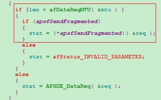

Round 1. PC send 81 bytes to ZR1 (no fragmentation). Test result is ok.
Round 2. PC send 81 bytes to ZR2 (no fragmentation). Test result is fail and no packet output from ZC.
Round 3. PC send 78 bytes to ZR2 (no fragmentation). Test result is ok.
We find the difference between round 2 and round 3 is relay information. The round 2 have additional relay information (4 bytes) in the frame. Besides, the round 2 will return fail status (0x10) when it calling AF_DataRequest().
I check the AF_DataRequest will decide fragmentation at this layer then call lib of "(*apsfSendFragmented)( &req )", after next hop ZR1 to ZR2 will additinal relay information (4 bytes) in the frame that will over the len of afDataReqMTU( &mtu ),but no perform fragmentation then fail. Round3 reduce the size to 78 byte for hop to ZR2 will can succses.

    According to the ZigBee specification, the relay information is added by network layer and the fragmentation is handled by APS layer. The round 1 testing result in the pattern length (81 bytes) does not need fragmentation. The round 2 testing still not needs fragmentation that pass through the APS layer. But, when data pass down to the network layer, it has to add relay information ZR1 to the destination ZR2. At this moment, the frame size is not enough to add it and the AF_DataRequst() return a error code 0x10 (memory fail).

    This is a known Z-Stack problem, but unfortunately it's not easy to provide a quick fix. Since the stack development is looking at this, the fix will be made in some future version. In the meantime, please send safely shout packet considering the length of the relay information when you use source routing. Sorry for your inconvenience.

    Under the condition where only NWK-layer security is used and the packet is source-routed, the safe payload size for AF_DataRequest() would be calculated as
    MaxPayloadSize = 79 - 2 x (number of hops)
