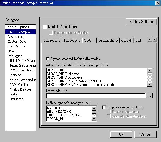

  • Don't understand your problem well. Try to explain step by step. Basically, coordinator, router, or end device would keep their network status if you define NV_RESTORE on them. When power recycle them, it will restore to previous status.

  • You can disable HOLD_AUTO_START in C/C++ Compiler option and device will start to search Zigbee network automatically.

  • Hi Denis,
    the function that you are looking for is ZDO_StartDevice().
    To YK's point, the end device are going to perform a network discovery automatically if HOLD_AUTO_START is disabled, that is why he's saying that you just need to undefine that compilation flag and your end devices should start doing an active scan and looking for the network.
