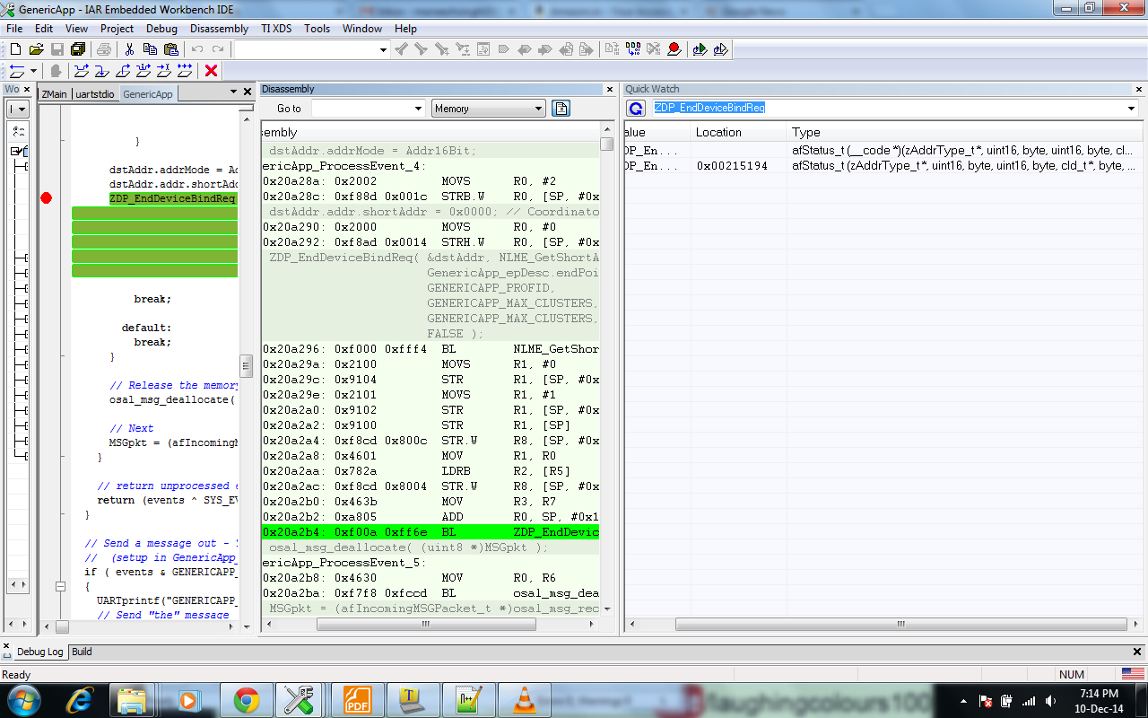

  • Hello YiKai Chen sir,
    Thanks for reply.....
    as u suggested i did the same things ... now i am sending end device binding request when ZC/ZED goes to ZDO_STATE_CHANGE as follows ->
    zAddrType_t dstAddr;
    case ZDO_STATE_CHANGE:
    GenericApp_NwkState = (devStates_t)(MSGpkt->hdr.status);
    if ( (GenericApp_NwkState == DEV_ZB_COORD) ||
    (GenericApp_NwkState == DEV_ROUTER) ||
    (GenericApp_NwkState == DEV_END_DEVICE) )
    // Start sending "the" message in a regular interval.
    osal_start_timerEx( GenericApp_TaskID,
    GENERICAPP_SEND_MSG_EVT,
    txMsgDelay );
    dstAddr.addrMode = Addr16Bit;
    dstAddr.addr.shortAddr = 0x0000; // Coordinator
    ZDP_EndDeviceBindReq ( &dstAddr, NLME_GetShortAddr(),
                                                    GenericApp_epDesc.endPoint,
                                                    GENERICAPP_PROFID,
                                                    GENERICAPP_MAX_CLUSTERS, (cId_t *)GenericApp_ClusterList,
                                                    FALSE  );
    break;
    but i am facing one problem ->
    1) i made one device as ZR and one as ZC......... and in ZR i  set a breakpoint at ZDP_EndDeviceBindReq()  and i noticed that it keep sending beacon request and keep hitting the breakpoint but not getting bind with the ZC.... becoz of that ZR is not able to send / receive the msg.....
    here is the screen shot which i am attaching with this mail...
    plz check it and tell me what i am doing wrong ?
    why it is keep hitting ZDP_EndDeviceBindReq() fn and sending continues Beacon request but not getting bind with ZC....
    plz help me.....
    and will you plz tell how to  send source files in forum.....earlier one tab/button was provided to attach and send source file but now in this new look i am not seeing that tab/button for sending files......
    Thanks & Regards,
    Maneesh singh
  • Try the following revision
    txMsgDelay );
    GENERICAPP_PROFID,
    FALSE );
    break;
    as u suggested i tried the same and now it is working....
