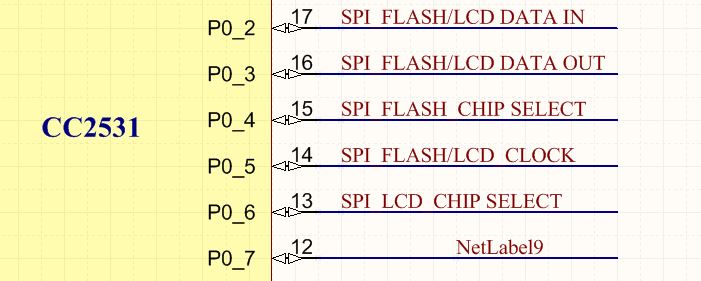

Can I use a single SPI in sharing  mode?
for example if I am to use a SPI LCD & SPI FLASH both with port0 of this IC with an addition of a GPIO (configured as SPI chip select feature) will this topology work?

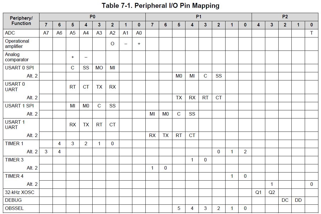

Can any GPIO other than the dedicated GPIO for UART or SPI be programmed as SPI chip select?
Please see the below schematic as reference.
Pin mapping for this IC is as follow
