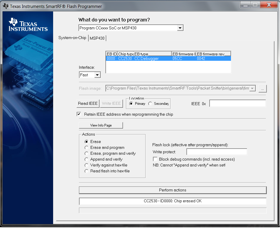

    Can you please suggest for the following are the errors(its not related to zigbee).i am getting following errors and my program is not getting downloaded in CC2530.
    Warning: Flash page 0 is locked and was not written to.
    Warning: Flash page 64 is locked and was not written to.
    Warning: Skipped verification on page 0 due to lock bits.
    Warning: Verification error on page #1, address range 0x00800 - 0x01000, address 0x00803, 0x08 (on target) != 0x09 (in object file).
    etc.
    What may be possible cause for these type of errors?
    I don't know why my all previously tested program are not working even though i didn't make changes in both hardware and software. i have tried by testing with different hardwares and previously tested softwares but none of them are working. With most sofwares end device is not sending beacon request.
  • Try to use flash programmer to erase CC2530 and download FW again.
  • I had tried by erasing and then downloading my program but it doesn't solve the problem. Same error i get for all the codes i am trying to download. What do you mean by "download FW again"? do you mean to program cc2530 after erashing using flash programmer or something else?
  • Yes, I mean to program CC2530 after erasing using flash programmer. Do you try to install a new z-stack to build and download example to see if it works?
    • Ya, i had tried to download new z-stack example code but result is same. here i have included snapshot of setting for erasing flash. Do i need to erase secondary memory also?
  • Do you try to download the same FW to another HW? It might be CC2530 flash broken.
  • I too think there is problem with flash because same program is getting downloaded in other hardware. What may be possible cause of flash failure? Is it programming it again and again? secondary memory should be erased or not?
  • Programming CC2530 again and again shouldn't damage the flash. Is it possible that you give wrong voltage input to VDD of CC2530 and damage it?
  • No, I have always used ccdebugger to power it and was working with same setup before. Some other cause may be there.
  • Maybe…Anyway, it seems the HW is broken and you have to replace it with another new.
