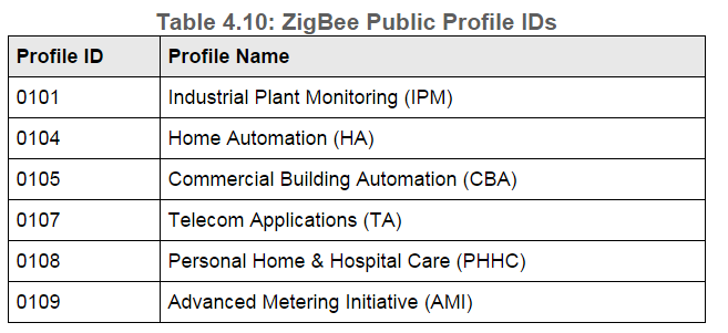

  • Hi Yikai,
    here i have included part of zigbee profile definition from
    As they have mentioned profile ids are manufacturer-specific profiles and public. So for my application which one should i use manufacturer-specific profiles or public? In public profile they have mentioned home automation profile id as 0x0104.
    1)Will profile id be same for all the sensor if i want to use home automation public profile? They have mentioned
    but when i used profile id as 0x0f01 then the coordinator was not receiving data althogh coordinator and end device were getting binded and end device was sending data also but when i used 0x0f10 then coordinator was receiving data.
    2)So can you please suggest which will be better to use for my application.
  • 1. If you use HA profile, all devices should use 0x0104 as profile ID. Otherwise, they cannot talk each other.
    2. Can you describe your application so I can suggest? However, I suppose you should use HA profile.
