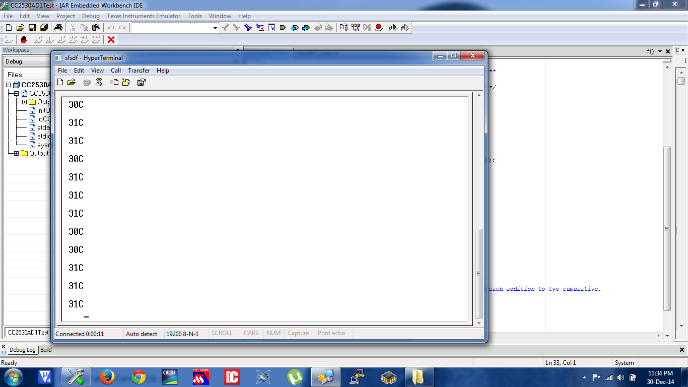

    using this pgm i am trying to display the value in the variable adcvalue via hyperterminal but it keeps on varying ... it is not steady sir

  • hi sir ..
    i did the coding as u said but yet it is not at all giving a stabilized value sir !!
  • This variation seems fine and it might be cause by AVDD variation.

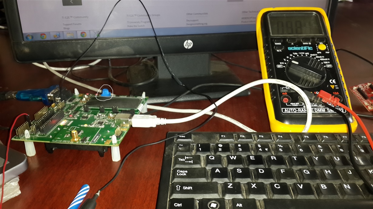

  • What is the input voltage on your ADC pin when your UART shows 63?
  • 3.275v i am getting at maximum value of the potentiometer ...
    112.4 mv for minimum value of the potentiometer sir ..
  • Can you take a picture of your HW?
  • the rounded part is the potentiometer which i used sir .. kindly see to it
  • it is the normal cc2530dk board and i am using ist inbuilt potentiometer sir
