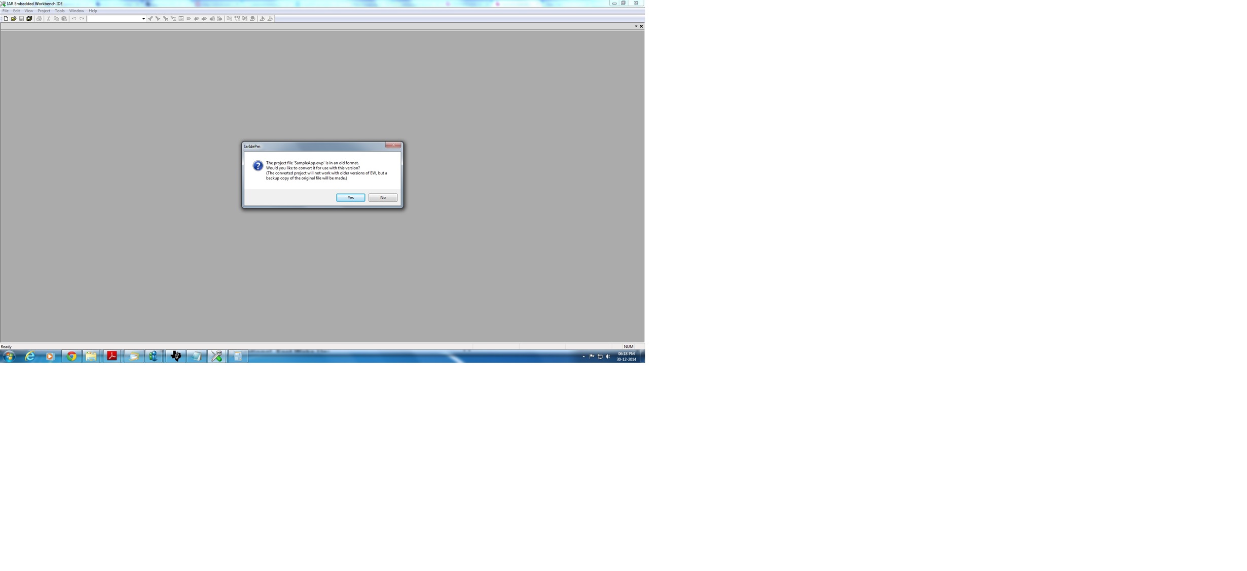

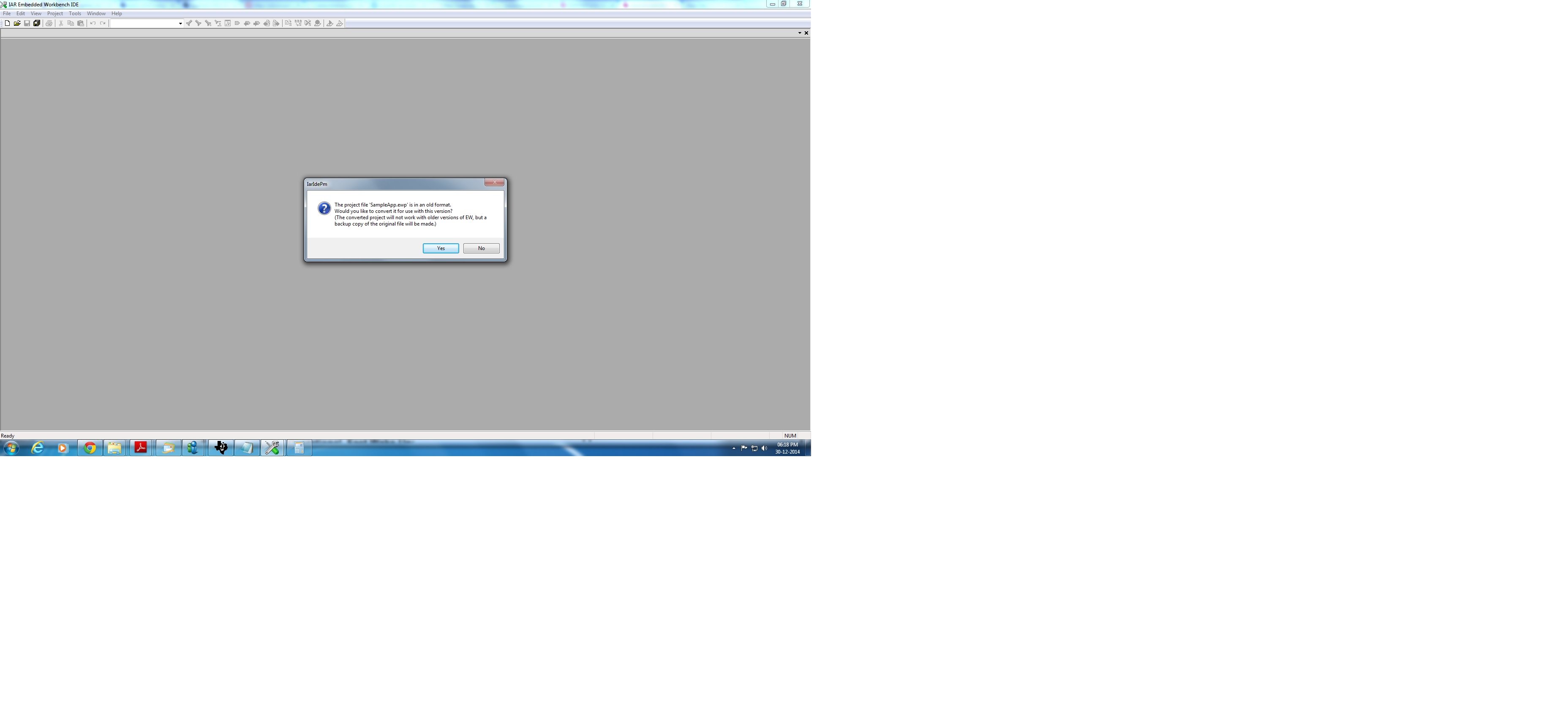

    I am using MSP430F5438 Experimenter Board with cc2520.
    IAR version is 5.60.6.
    ZStack-EXP5438-2.5.1
    I don't made any changes in existing code. I just build the existing code and it produced the linker error.
    Already I have tried the optimization settings. But It doesn't resolve the error.
    please see the attached image. it was popped up, when I opened the project first time
    Is it problem for this linker error?
    Keerthi G.
