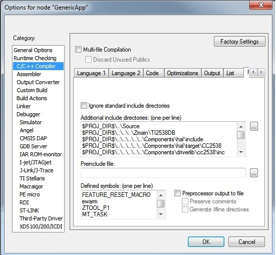

  • In project options go to C/C++ compiler tab and then in the  Preprocessor tab, add the paths to all the necessary include files.
  • Is there a way to have it include sub-directories automatically? This way I have to manually enter many 50+ directories
  • Ideally the stack should install and build in IAR without having to change any paths. I just tested the stack on IAR 7.3.
    Attached is the path environment for the project. Try changing yours to this.

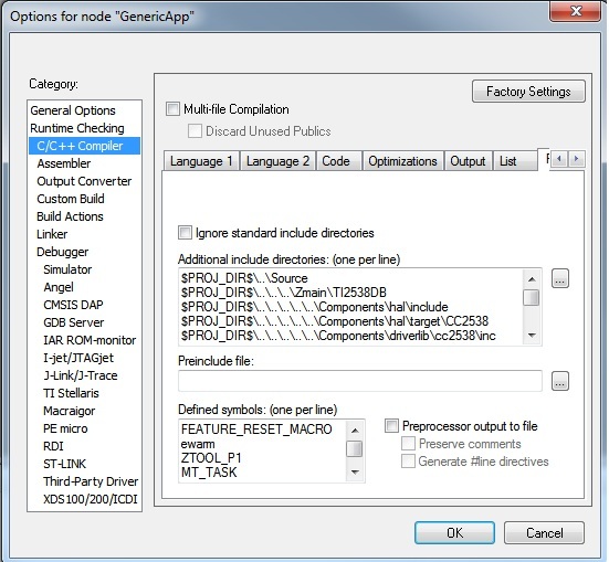

    I was able to build the project in IAR 6.7 by copying project options from IAR 7.3. IAR 6.7 gave me broken link errors so i believe this may have to do with the versions.
    See if the steps below help in IAR 6.5.
    1. Copy paste the include paths in the preprocessor pane:
      $PROJ_DIR$\..\Source
    $PROJ_DIR$\..\..\..\Zmain\TI2538DB
    $PROJ_DIR$\..\..\..\..\..\Components\hal\include
    $PROJ_DIR$\..\..\..\..\..\Components\hal\target\CC2538
    $PROJ_DIR$\..\..\..\..\..\Components\driverlib\cc2538\inc
    $PROJ_DIR$\..\..\..\..\..\Components\driverlib\cc2538\source
    $PROJ_DIR$\..\..\..\..\..\Components\sdriverlib\cc2538\source
    $PROJ_DIR$\..\..\..\..\..\Components\bsp\srf06eb_cc2538\drivers\source
    $PROJ_DIR$\..\..\..\..\..\Components\mac\include
    $PROJ_DIR$\..\..\..\..\..\Components\mac\high_level
    $PROJ_DIR$\..\..\..\..\..\Components\mac\low_level\srf05\single_chip
    $PROJ_DIR$\..\..\..\..\..\Components\mt
    $PROJ_DIR$\..\..\..\..\..\Components\osal\include
    $PROJ_DIR$\..\..\..\..\..\Components\services\sdata
    $PROJ_DIR$\..\..\..\..\..\Components\services\saddr
    $PROJ_DIR$\..\..\..\..\..\Components\stack\af
    $PROJ_DIR$\..\..\..\..\..\Components\stack\nwk
    $PROJ_DIR$\..\..\..\..\..\Components\stack\sapi
    $PROJ_DIR$\..\..\..\..\..\Components\stack\sec
    $PROJ_DIR$\..\..\..\..\..\Components\stack\sys
    $PROJ_DIR$\..\..\..\..\..\Components\stack\zdo
    $PROJ_DIR$\..\..\..\..\..\Components\zmac
    $PROJ_DIR$\..\..\..\..\..\Components\zmac\f8w
    2. Copy paste the below in "Defined symbols: (one per line) box in the Preprocessor window pane
    FEATURE_RESET_MACRO
    ewarm
    ZTOOL_P1
    MT_TASK
    MT_SYS_FUNC
    CC2538_USE_ALTERNATE_INTERRUPT_MAP=1
    MT_ZDO_FUNC
    LCD_SUPPORTED=DEBUG
    3. Copy paste the below in the "Extra Options" tab of the C/C++ Compiler category.
    -f $PROJ_DIR$\..\..\..\Tools\CC2538DB\f8wConfig.cfg
    -f $PROJ_DIR$\..\..\..\Tools\CC2538DB\f8wCoord.cfg
  • Forgot to mention that the above is for the GenericApp project of the Z-Stack Mesh 1.0.0 software.
    You can follow a similar approach for Zigbee Home as well.

  • I was able to Build Home 1.2.1 with 7.30. It failed giving Broken links in 6.5.
  • Different Z-Stack version uses different IAR version. I suggest use IAR version that is described in release note.
  • I still have linking problem even using the version in release notes. (6.50.5 with zstack home 1.2.0)
    any thoughts?
    4 file(s) deleted.
    Updating build tree...
    boot_main.c
    hal_sys_ctrl.c
    startup_ewarm.c
    Linking
    Error[Li005]: no definition for "SysCtrlReset" [referenced from C:\Texas Instruments\Z-Stack Home 1.2.0\Projects\zstack\OTA\Boot\CC2538\Image_Boot_Manager\Obj\
    startup_ewarm.o]
    Error[Li005]: no definition for "IntMasterDisable" [referenced from C:\Texas Instruments\Z-Stack Home 1.2.0\Projects\zstack\OTA\Boot\CC2538\Image_Boot_Manager\Obj\
    boot_main.o]
    Error[Li005]: no definition for "SysCtrlDeepSleep" [referenced from C:\Texas Instruments\Z-Stack Home 1.2.0\Projects\zstack\OTA\Boot\CC2538\Image_Boot_Manager\Obj\
    boot_main.o]
    Error[Li005]: no definition for "SysCtrlPeripheralDeepSleepDisable" [referenced from C:\Texas Instruments\Z-Stack Home 1.2.0\Projects\zstack\OTA\Boot\CC2538\
    Image_Boot_Manager\Obj\hal_sys_ctrl.o]
    Error while running Linker
  • If you configure Linker in Project Option as below it will work and give no errors:
    Linker:
    config: $PROJ_DIR$\Source\cc2538.icf
    Linker/library:
    $PROJ_DIR$\..\..\..\..\..\Components\driverlib\cc2538\bin\iar\sdriverlib.lib
    $PROJ_DIR$\..\..\..\..\..\Components\bsp\srf06eb_cc2538\drivers\bin\iar\bsp.lib
    __iar_program_start
