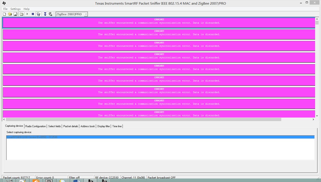

  • If you already disable HOLD_AUTO_START, it is not the root cause. Do you try to use Ubiqua Packet analyzer to have a look?
  • Ubiqua Packet analyzer?
    En Packet sniffer?
  • Since Zigbee HA protocol is encrypted, I suggest you using Ubiqua Packet analyzer. If you use TI packet sniffer, the data is encrypted.
  • Hi yikai
          although  i disable SECURE=1。
          it can't be  catch~·~~~
  • Try to download trial version of Ubiqua Packet Analyzer. It is useful in debugging.
  • unfortunately, there is error happen while install ubiqua tool

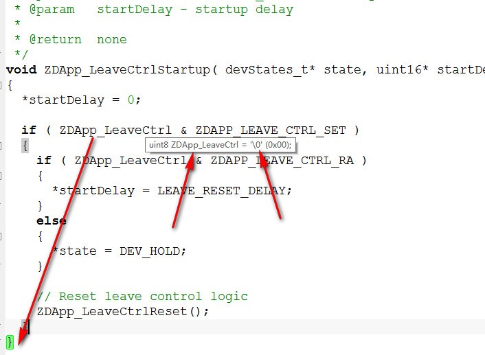

  • There is only two places that would set it to DEV_HOLD, ZDAppCheckForHoldKey() and ZDApp_LeaveCtrlStartup(). You can set breakpoints on them to check why it is set.

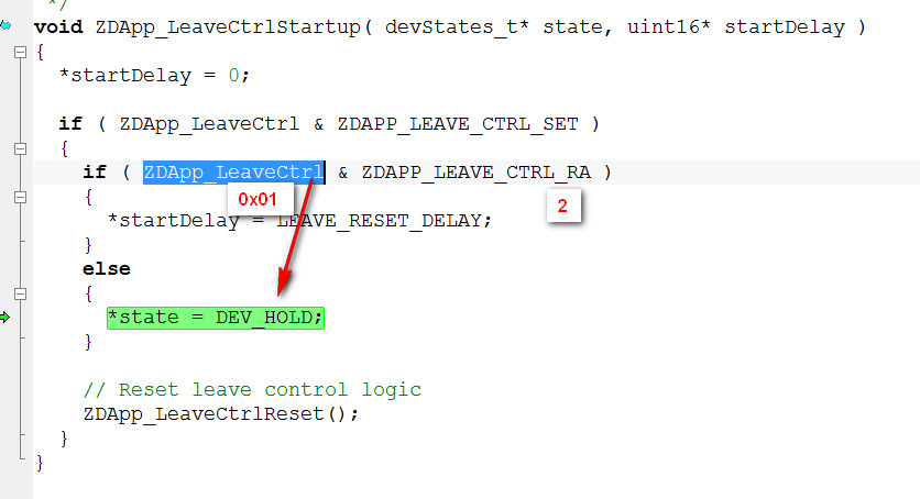

  • Hi Yikai
              when i doing debug,i find that it is different result between two case
             in the first case  ZC always power on:
                ZDApp_Leave_Ctrl  is  0x00
             in the second case ZC was power off while  ZED doing factory reset
             ZDApp_Leave_Ctrl  is  0x01
             and after doing if ( ZDApp_LeaveCtrl & ZDAPP_LEAVE_CTRL_RA ) it turn to      *state = DEV_HOLD;
            although   ZDAPP_LEAVE_CTRL_RA  is 2  Why that will be fasle ?????
  • Do you send leave request with rejoin flag = false? If so, it would set dev_state to DEV_HOLD.
  • i got it ,it is here
    Do you find anything wrong as below ?
    if ( NLME_LeaveReq( &leaveReq ) != ZSuccess )
    ZDApp_LeaveReset(FALSE ); // TRUE
    i don't know why TI set this logic here ?
  • This is about application behavior and you can change it. They just make the application prepare to reset anyway if device couldn't send out leave.
