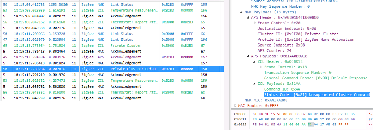

  • Follow "I would suggest you using AF_DataRequest to send proprietary data with AF_ACK_REQUEST Option. If ZR receives message, it will send ack in AF_DATA_CONFIRM_CMD."... I had try modify:
    step#1: ZC send data by that using AF_DataRequest to send proprietary data with AF_ACK_REQUEST, and
    step#2: ZR's patch as below for always send ZFailure to ZC for my proprietary ZCL_CLUSTER_ID_XX
    @@ -274,6 +274,7 @@ static ZStatus_t zclGeneral_PHdlIncoming( zclIncoming_t *pIn
    +stat = ZFailure; //@@test^M
    return ( stat );
    step#3: test/confirm OK by  sniffer as below for that ZR return ZFailure(0x81)
    step#4: then ZC's patch as below, but "sentStatus" alway is 0x00

    so ZC can't get ZR's return stat by AF_DATA_CONFIRM_CMD....
    Please help... maybe lose something ?
  • Dear YK,
    As reply(Jan 21, 2015 11:02 AM),
    Do you know how to get ZR's return Status(ex. 0x81) for ZC ?
  • Since you use private cluster, you have to do APS ack by yourself.
