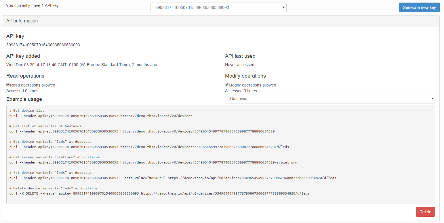

When it works perfectly, is it possible to log data from the Thingsquare Webpage?
What kind of data could be retrieved from the Thingaquare webpage?

    1. Yes it is possible to use the API on the demo server. You need to generate a new key, also make sure to tick the "enable read and modify operations" check boxes. You have example code directly in the window on how to access the data via the REST API using e.g. curl.
