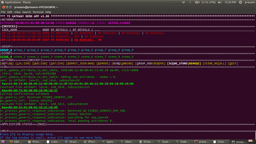

    I did the following steps given in Z-Stack Linux Gateway User's Guide (Page 12) to use SCENE functionality:
    6.3.3.6 Scenes

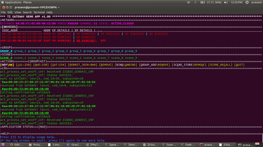

    - I have added a number of devices to a group(nwk address 65C0 and ep 09, nwk address 0187 and ep 08, GROUP_0).
    - then I adjusted the settings of each device to a desired value (for Light devices, OFF/ON).
    - I have used the shortcut key "E" to store the scene.

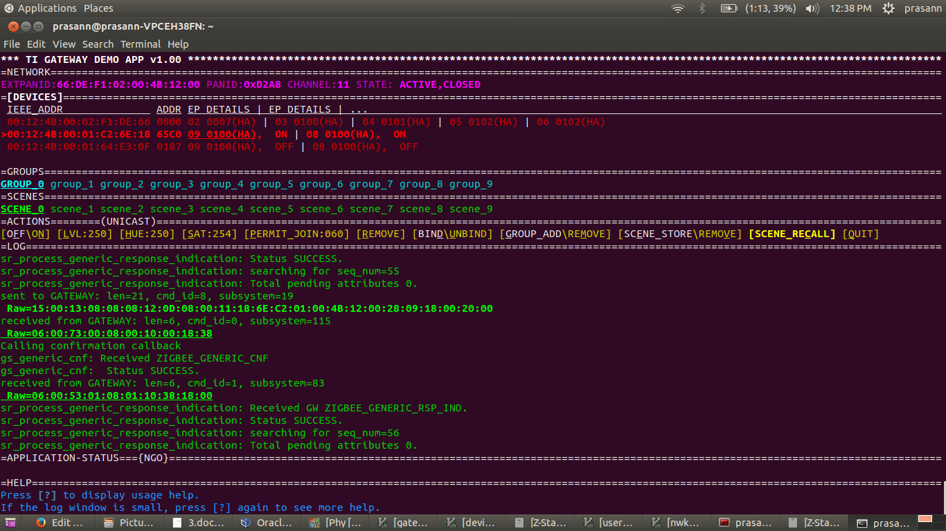

    - After that I changed the settings of the device individually or as a group.
    - While recalling the scene using “C”
    either as a group (if in Groupcast transmission mode) or individually (if in Unicast transmission
    mode), I am not able to see any indication.
    Where am I making mistake?

    I was looking through SampleLight application. The ZCL_ID_GEN_GROUPS and ZCL_ID_GEN_SCENES clusters were included in the input cluster list of the SampleLight application. But neither a single command nor an attribute has defined for these two clusters and still the GROUP action works.
    Then why is it not working for SCENE action?
