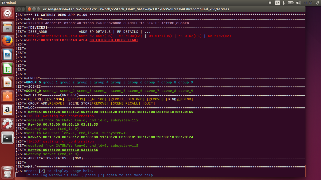

  • Hi YiKai,
    I have built x86 binaries. But there are some error after I run the "./zigbeeHAgw x86". Do you know what's the possible root cause?
    running zigbeegw.scr on an x86
    skipping zigbee reset
    Starting the ZigBee gateway subsystem
    deviceKey = 0 (0 )
    devPath = '/dev/ttyACM0'

    I can run it on x86 successfully. I would like to buy light bulb or power outlet for testing. I heard that some light bulbs are not compatible with third party's gateways. Is there compatible devices list for z-stack linux gateway? Thanks.
  • TI Linux Home GW is based on Zigbee HA profile so all of Zigbee HA certified devices can be used by it. You can find Zigbee HA light bulbs in the following link.
    www.homedepot.com/.../205404345
  • I bought a Philips Hue bulb first since it's available in Taiwan now. But it doesn't appear in device list. Below is the packet sniffer log. Do you know how to make it work? Thanks.
    PhilipsHue.psd
  • I see a device with IEEE address 00:17:88:01:00:FB:2D:A8 sends association request and get response from coordinator with IEEE address 00:12:4B:00:02:F1:DC:40. Then, it stops there. Does your Philips Hue with IEEE address 00:17:88:01:00:FB:2D:A8? By the way, you can try to contact TI Taipei FAE to help you. The have good experiences in this.
  • Yes, that's Philips Hue's IEEE address. I restarted my linux pc and z-stack, then it can appear in device list now. It seems that z-stack is not reliable after I wake up my linux PC which has slept three days. By the way, I can adjust Level, Hue, Saturation successfully, but there are TIMEOUT message in log sometimes. Do you know the reason? Thanks.
  • I don't know why you have this timeout problem. Do you send on/off or change level command in short period? By the way, I would suggest you using Ubiqua Packet Analyzer to check over the air message. It will help you a lot to verify problem.
  • I tried to send command in long period, but it still displayed timeout message. However, the action is done successfully.
    Thanks for your suggestion, I will try to use Ubiqua Packet Analyzer later.
