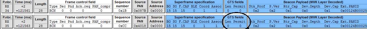

Zigbee data packet transmission is based on GTS concept or CSMA / CA concept.
I mean GTS means coordinator allocate the every router packet to certain time slot and CSMA / CA means coexistence purpose.
ZigBee networks are non-beacon. Non beacon means asynchronous, not that is it is not using the 'Beacon' type of frames. GTS is used in deployments where the 802.15.4 coordinator periodically emits beacon, and as mentioned this is not the case in ZigBee.
The frame format of the Beacon frame as standardized in IEEE 802.15.4 spec includes GTS field, but in the context of ZigBee all the fields are 0 which in fact means that the coordinator does not permit GTS requests and that there's no GTS descriptor allocation.
Hope this clarifies.
