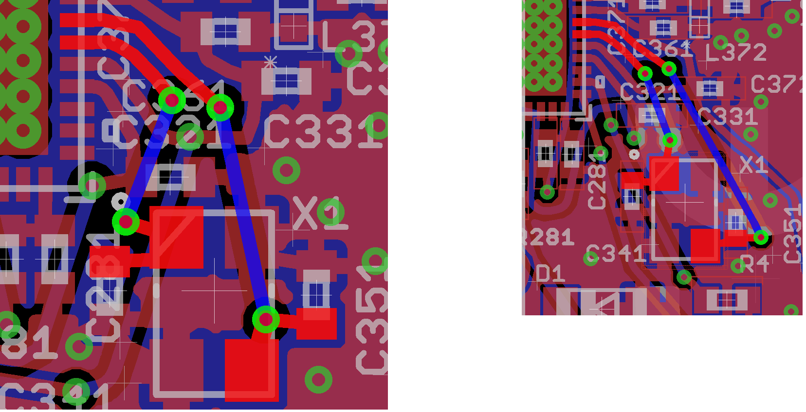

The right layout is an older version of my board which totally works fine. The left one is the newer version where I placed the components closer to each others (as well as the crystal). However, the 32 MHz crystal does not work properly on the new board ( I carefully assembled three of them).
I measured the pins of crystal by an oscillator, and I see the logic level of pins goes a higher, but don't oscillate. In addition, my code gets stuck on externalclock initialization (BoardInit() ).
Does anyone see any possible problem or have any suspicion or have any suggestion to debug/solve the problem?

    Did you test this crystal on your old board or on CC2538EM?
    Do have Scope/Spectrum Analyzer to test the Osc frequency?
    Did you get the correct frequency (32MHz) crystal?
    Measure the resistance in between the Crystal pin and crystal case. It should be high. Some times, if the assembly is not good, it may short to Ground.
    Measure the continuity in between the Crystal pins and CC2538 pins for any open circuit.
    First make sure the Crystal is oscillating. you may test it on CC2538EM.

    I did all of them. No short circuit on the layout or after the assembly. I clean my board against the flux residues.
    When I measure the 32MHz crystal's pins, one pin was on logic high, but wasn't oscillating. Then I added 1M ohm parallel to the input/output pins to create imbalance. As a result, the crystal started working. However, I still couldn't understand why the crystal works on the old board without need of any additional resistor but it needs on the new board.
    Before adding the resistor, my code was getting stuck on the ROM area. After adding the resistor, the program flows normally. But, I still have a problem.
    I have three identical custom boards. One works fine and I see its radio output signal on the CC2530 sniffer; the second one gets stuck on MAC timer start on the code and not radio output;  the last one's code flows without any problem, however, it does not transmit any radio packet (I use the same SW, Z-stack generic App, on the boards).
    I measure the oscillation frequency of the crystal as 32 MHz on three boards. Do you have any guess why the program would not be able to start the MAC timer or the program flows normally but it does not output any TX signal? Is there any definition on Z-stack that if the frequency's ppm is more than 40 ppm, then TX interface would not work?
