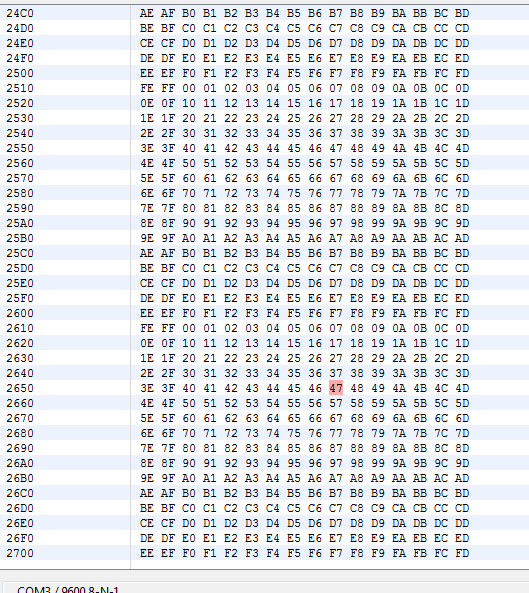

  • Hi Hector,
    Can you please give me an example code to output: 1, 2, 3 , 4, 5,......
    The parameter for pSrc is 8 bits, so I am not sure how to output a number.
    Following is my code:

        uint16_t spiLength = 10;
        // Enable the USB interface
        usbCdcInit(115200);    //void usbCdcInit(uint32_t baudrate);

  • However, I get the results from terminal like:
  • It seems that your output of serial port is in hex format. You should use another tool that can show hex format to check what these characters are.
  • The reason why you see that on the terminal is because the terminal will print character in ASCII and you are sending raw numbers which are not being properly converted to its equivalent in ASCII.
    Also in your code you are using the pointer psr which length is 1 but when you send it back you say the size of the buffer is 10.
    Note that pSrc is a pointer to the buffer that contains the string that will be sent to the USB host so for example if you want to send the number 25 you will have to have a buffer with the character '2' and '5' instead of sending the integer 25.
  • Hello YiKai,
    Thank you for your information. I try to use other serial port terminal, and the hex format for my output like the following figure.
    Now, I am lost, and I do not know how to solve this problem.
  • The output is regular and sent by your application. Why don't you know where it is from?
  • did you change spiLength to 1 instead of 10?
  • Hello Hector,
    The results are correct after I change the spiLength to 1.
