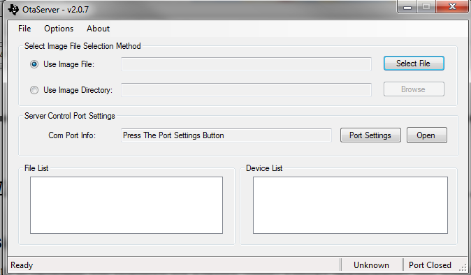

Where to get OTA Console?
Other Parts Discussed in Thread: Z-STACK
Where can I download  OTA Console from?
I have only OTA server in my Z-stack distributions:
  • Would you please help me with this question?
    I am following:
    Z-Stack OTA Upgrade User’s Guide
    Document Number: SWRA353
    I also don't see Network Manager referred in section 2.2.3
  • To use OTA console, you just open a DOS console and switch path to "C:\Program Files\Texas Instruments\OtaServer". Then you can use command "OtaServer -p "COM1" -s "38400,CTS/RTS,None,One,8" -ch 0x0B -pa 0xFFFF -de 0xFFFF -e 0xff -f "c:\my ota
    files\ota image.zigbee" -l "logfilename” -NoVersionCheck" in console.
