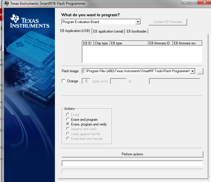

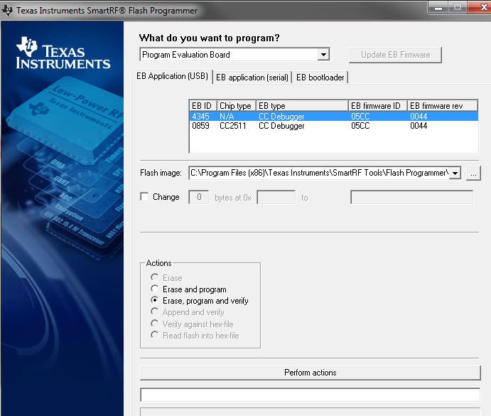

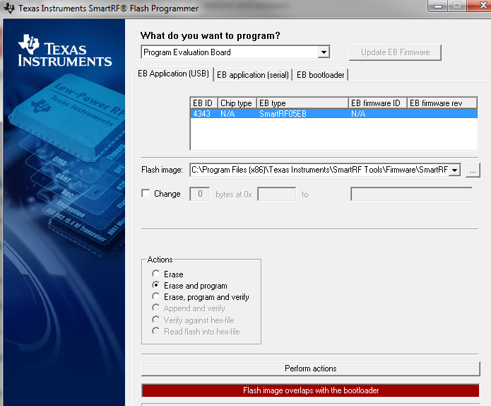

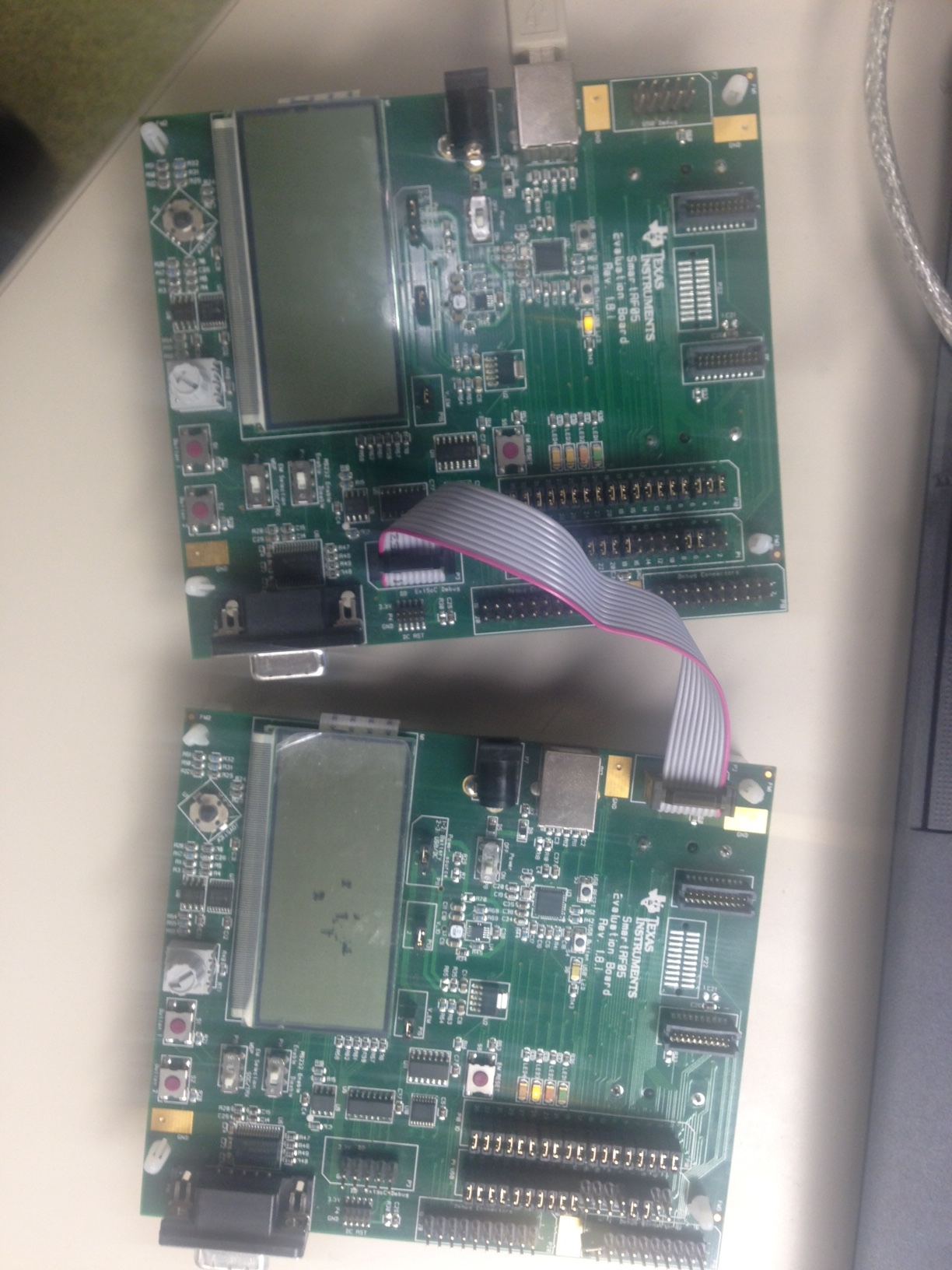

I have a smartRF05 board which needs to be re-programmed.
I short circuited pin17-19 and connect it via USB cable to PC, BY turning it on flash programmer identifies the board but does not recognize the firmware.
When I try to flash it with the supplied hex file
\usb_bootloader_srf05eb.hex
It refuse to do so by displaying :
Flash image overlaps with the bootloader
Even when I want to only erase the whole memory it doesn't allow.
I appreciate any insights.
