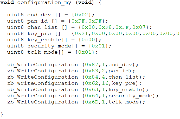

1) Registered in the configuration in NV items (ALL DO RIGHT see last drawing)

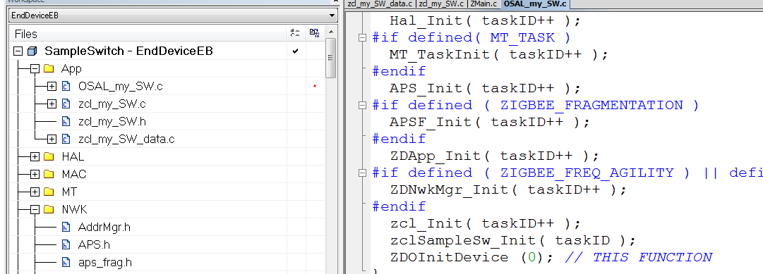

2) Launch ZDOInitDeviche (see first drawing)

    Example, my coordinator have:
    uint8 key_pre [] = {0x39,0x30,0x65,0x63,0x6E,0x61,0x69,0x6C,0x6C,0x41,0x65,0x65,0x42,0x67,0x69,0x5A};
    uint8 key_enable[] = {0x00};
    uint8 security_mode[] = {0x01};
    uint8 tclk_mode[] = {0x01};
    And my End Device has the same settings.
    But it still does not work. The device starts, connects to the network, receives a command Association Response (Successful), and the command Transport Key, and then begins to many many times to send in network comand Data_request. I already broke my whole head in troubleshooting...

    2) called ZDOInitDevice(0); after zclSampleSw_Init( taskID ). in file OSAL_SampleSw.c
    And it did not work.
    Then I got into the firmware of its coordinator works and find out how it is run. As a result, I wrote configuration (see figure), which is written to memory. And those two items add it :
    1)disable HOLD_AUTO_START.
    2) called configuration_my () before macTaskInit( taskID++ ). in file OSAL_SampleSw.c
    3) called ZDOInitDevice(0); after zclSampleSw_Init( taskID ). in file OSAL_SampleSw.c

    configuration_my (); // I DO THIS

    zclSampleSw_Init( taskID );
    ZDOInitDevice(0); // I DO THIS
    And it worked, but not as much as I expected. The device reboots, 20 seconds after successfully connecting to the network.

  • Definitely! POLL_RATE setting !!! As I just did not think =) There's also a whole bunch of settings =) I realized what my problem! It is necessary to register all the settings that are, not just the ones I ordered =) Thank you very much =)
