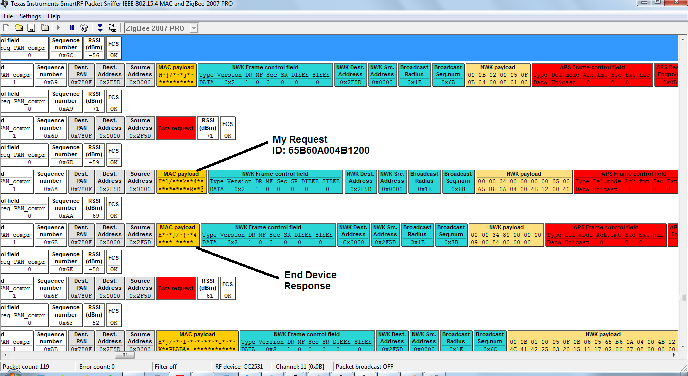

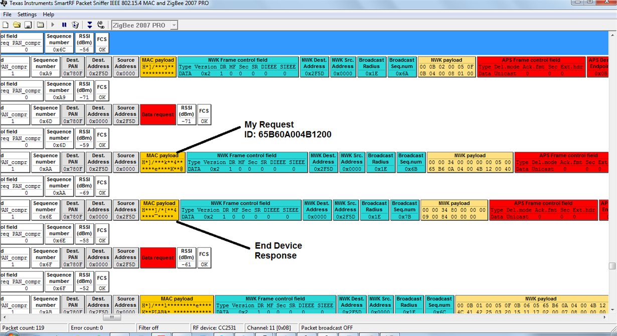

    Thank you for your response,
    The End Device doesn’t respond to this request ZDP_NwkAddrReq using by IEEE address.(I can able to see the request from coordinator no more response from correspond ieee end device)
    I tried with below options:
    In compiler options i enabled in
    ZDO_NWK_ADDR_REQUEST
    xxx_init functions
    ZDO_RegisterForZDOMsg( TaskID, NWK_addr_rsp );
    If i request for ZDP_IEEEAddrReq using by short address its work fine and i can able see in the sniffer req and response of the end device IEEE address.
    Please can you suggest me if settings are needed.
    Siva J

    when i am trying to send ZDP_MgmtLeaveReq device is still in network it does not leave from my network.
    My leave request:
    /* Destination Address */
    destAddr.addrMode = Addr16Bit;
    destAddr.addr.shortAddr = Endevice_shrt_address;
    retValue = (byte)ZDP_MgmtLeaveReq(&destAddr,pIEEEAddr, 1, 0, 0);
    My Compiler Options for coordinator:
    ZDO_MGMT_LEAVE_REQUEST=1
    MT_ZDO_MGMT=1
    I can able to see in the sniffer send request and response from the my end device. But end device still in network
    Is there any settings,
    How do i confirm whether the end device leave from my network.
    Here my sniffer log file when sending req to device from coordinator.
    Can you please suggest to me if i have done anything wrong.
    Siva J
