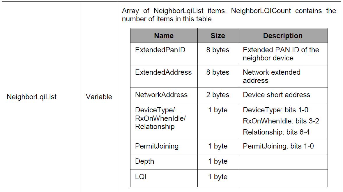

1. Where I can find description of these fields of ZDO_MGMT_LQI_RSP
DeviceType: bits 1-0
RxOnWhenIdle: bits 3-2
Relationship: bits 6-4
Depth
LQI

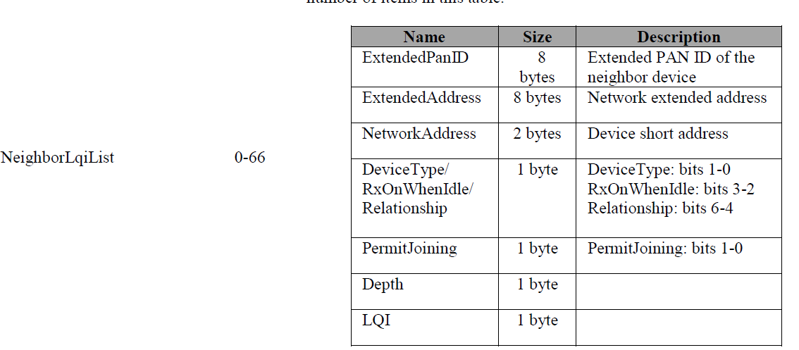

In "CC2530ZNP Interface Specification.pdf" I see this description
In "Z-Stack Monitor and Test API.pdf"

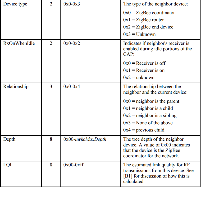

  • Hi Vasily,
    You can find this information in the ZigBee Specification document from the ZigBee Alliance.
    Here is the descriptions
