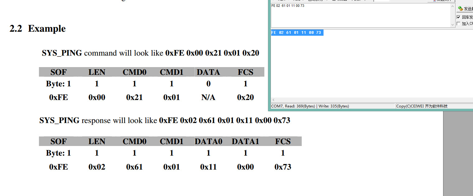

  • FE 02 61 01 11 00 73
    it same with MT format about SYS_PING

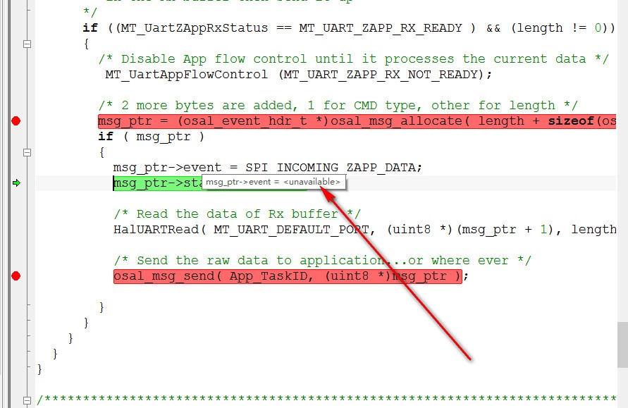

  • It was unbelievable, that msg_ptr->event was always showing unavailable ,although it was setting SPI_INCOMING_ZAPP_DATA
  • IAR can't show local variable in watch. You can add a global point to get msg_ptr if you need to watch it.

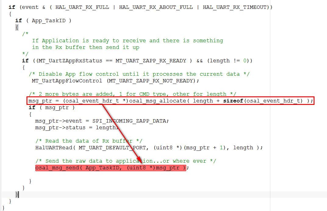

    i was confused with the MT_UartProcessZAppData() function  in MT_UART. c
            msg_ptr = (osal_event_hdr_t *)osal_msg_allocate( length + sizeof(osal_event_hdr_t) );
            if ( msg_ptr )
              msg_ptr->event = SPI_INCOMING_ZAPP_DATA;
              msg_ptr->status = length;
              /* Read the data of Rx buffer */
              HalUARTRead( MT_UART_DEFAULT_PORT, (uint8 *)(msg_ptr + 1), length );
              /* Send the raw data to application...or where ever */
              osal_msg_send( App_TaskID, (uint8 *)msg_ptr );
    what is the final type of data  it sending to App.c?
  • It doesn't matter since it is only a pointer. You can use zclSmartplug_ProcessUartData((osal_event_hdr_t *)MSGpkt); to directly map it to osal_event_hdr_t pointer. Or, you can use zclSmartplug_ProcessUartData((uint8 *)MSGpkt); and cast unit8 pointer to osal_event_hdr_t pointer in zclSmartplug_ProcessUartData.

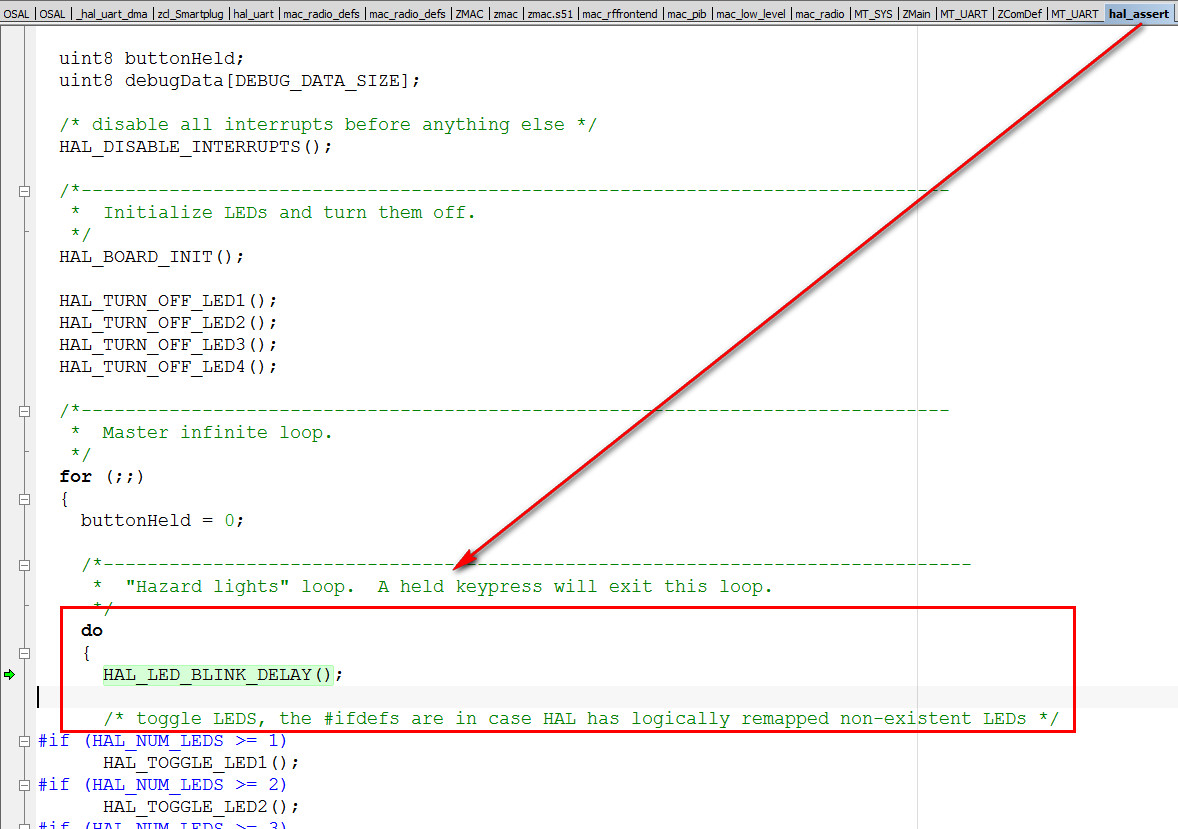

  • Hi  Yikai
         it was  always error.... and it turn to hal_assert.c    the blinking the LED

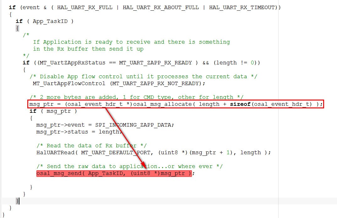

    so now the question is how to parse the data from the MT_uart.c
  • I am confused by you again. Basically, MT command is processed in MT_ProcessIncoming().
  • no , there is no MT command。
    now i want to received all the data from Uart , no matter what format it takes, so i define ZAPP_P1 ,not ZTOOL_P1
    but the question is ,i don’t know how to parse it out in APP.c
    because MT_UART.c change the data by using the MT_UartProcessZAppData() function。
    if ( msg_ptr )

    uint8 pBuffer[2];
    //pBuffer = osal_mem_alloc(datalength);
    if(pBuffer != NULL)
    for(i = 0;i < datalength; i++)
    // *pBuffer++ = *pBuf_tmp++; // change to array
    pBuffer[i] = *pBuf_tmp++;
    HalUARTWrite(0,pBuffer,datalength);
    // osal_mem_free(pBuffer);
    it was OK, do you know why ?
  • Do you check if datalength is too large and cause allocation failure?
  • i have , nomatter how long of the data it is , there is always being error ~~~~~
    as i think , maybe osal_mem_free() function will release the pointer as soon as possible,
    although it takes sometime for executing HalUARTWrite(),
    it is possible that when executing HalUARTWrite(),OS had already release the pointer,
    and that cause the error happen。
  • Yes, you are correct about this. It is possible that when executing HalUARTWrite, the buffer had already been released. I suggest you allocate a global array for this.
