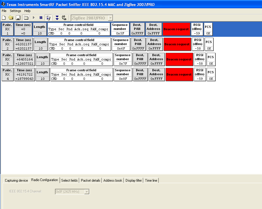

  • I am too thinking both devices are not getting properly resetted. But what outcome i should get after resetting both hue and centralite i am getting that. Like if i reset hue then hue light flashes for severaltimes and finally it turns red as what is expected it should be. Similarly centralite led glows after 2sec while pressing and holding the switch provided in it while powering.
  • ya. i am trying to factory reset and hue behaviour is same what it should be while resetting like it flashes for sometimes and finally turns red.
  • When you successfully do factory reset to hue, it would turn red and your will see it sends beacon request on all 16 Zigbee channels in Ubiqua Packet Analyzer. It is similar to centralite smart plug. If I remember correct, you have to hold the button, plug it to power socket, and wait the LED turn ON which means factory reset successfully.
  • Let's say the hue is retaining an short addr in PAN 0x12345678. Is the coordinator that is hosting PAN 0x12345678 present and acitve?
  • I see a single beacon packet in sniffer after factory resetting hue and not for all 16 channels.
  • No. i had tried by keeping the same panid as used by the hue like if hue has panid 0xb129 and if i set the default panid of my zc to 0xb129 then zc assigns 0xb130 as its own panid due to panid conflict
  • sorry i misunderstood your question. i don't know whether panid of hue is assigned by itself or by remote. if its assigned by remote then even after switching off remote same outcome i get. there is no any other device active.
  • If you want to see beacon request on all 16 channels, you have to connect 16 CC2531 usb dongles which receive from 16 channels. Do you do that?
  • I think you better make sure there is no other coordinator around. I was thinking if the hue retains 0xb129, could it be that it really joined back to pan 0xb129 after reset?
  • after factory resetting hue, i receive a beacon packet with packet description as ZLL commisioning read attribute
  • sorry, i have only 1 cc2531 usb dongle but one thing i find is whatever channel i select in sniffer i get a single beacon packet in all these.
  • I suppose this means Hue is sending beacon requests on different channels. If you use 16 CC2531 USB dongle, you will see beacon requests on 16 different channels.
  • Can you please tell me which device assigns panid of hue, phillips hue itself or phillips remote? As i had told earlier i had switched off all other devices and only my zc,remote and hue are in on condition. I had tested by switching off remote and power recycling my zc and hue. Then also i don't see association and same panid used for the hue in the sniffer log
  • Phillips hue itself assigns panid.

  • Earlier i had told that so many of my hardware are having problem in sending beacon request. Actually these devices were not sending beacon packets and i was thinking this as hardware problem. Finally i found reason(i may be wrong) for not sending beacon. Earlier was defining "HOLD_AUTO_START". I tried by disabling this and all my hardware are now sending beacon packets.
    Do you think this may be reason? If yes then why and what this parameter is used for?
  • Yes, I think this is the reason. HOLD_AUTO_START is for make device hold and not try to join any network. I always disable it in my project. However, it is for someone that don't want to try to join any network when device is power on.

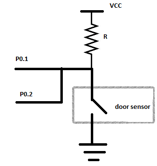

  • Hi Yikai,
    Is it possible to have port interrupt both at rising and falling edge? I want to sense interrupt at both conditions-either door is opened or it is closed?
  • CC2350 only supports rising or falling edge. If you need to check both, the alternative is connect it to two GPI, one check rising and another check falling.
  • Can you please explain the connection for connecting a single door sensor to two ports?
  • For example, you can connect door sensor circuit to both P0.2 and P1.2, in which P0.2 handles rising edge and P1.2 handle falling edge.
  • is it feasible doing this from hardware point of view? if sensor is connected to two pins then these pins may get shorted and drain voltage. I will try to change the interrupt edge configuration(rising to falling and vice versa)when interrupt occurs. With this way i think i can manage both interrupts for this case though first time
    it may create problem.
  • Why would these pins get short? I just suggest you wire the same signal to both P0.2 and P1.2.
  • Do you mean to have connection like this? if so then if either of the pin gets low there will be continuous drop in voltage and both pins will maintain same potential and hence no interrupt on the other pin.
  • Let's say if we have two door sensor like your circuit and connect to two separate pins. If both sensor go open or close together, do they have problem you mentioned? If not, why do we have problem when we use the same sensor?
  • Sorry. both rising and falling edge interrupts can be sensed with that circuit but more care has to be taken while configuring the pins as i/p. if by mistake any pin is configured as i/p and other as o/p then there will be continuous drop in voltage.
