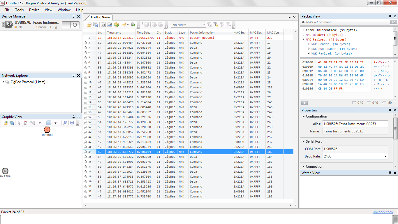

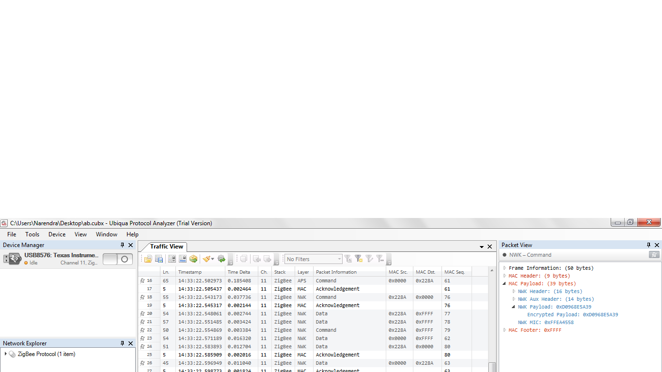

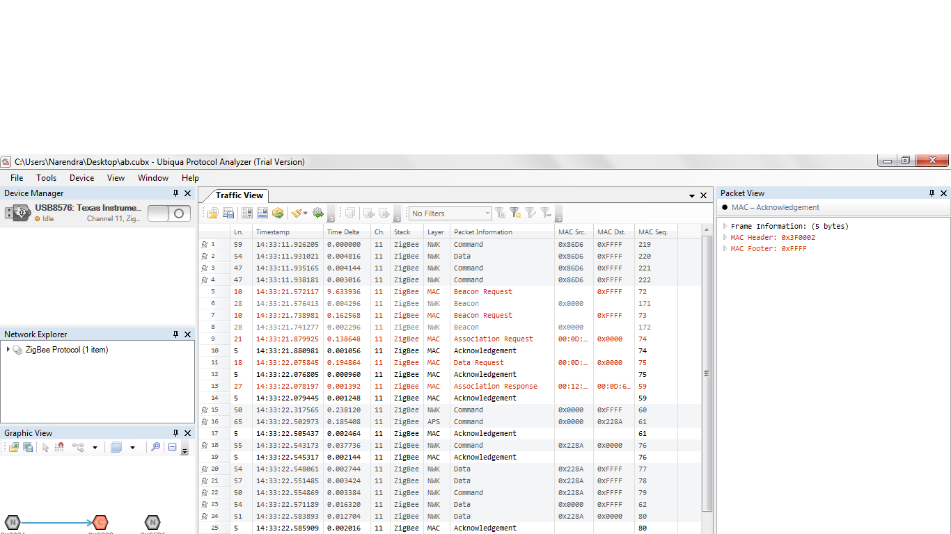

    2)Here i have included the data packets captured by ubiqua packet analyzer. I have downloaded trial version. In this log initially zc was powered and later i had powered on centralite. Can you please tell me whether centralite is asociated with my zc?  If its associated  then how can i test centralite? is it by plugging light to the terminal and sending light toggle command. I am trying to attach .cubx log but its not getting attached
  • I don't see any beacon request and association in your sniffer log so I believe the centralite device doesn't join ZC. Do you do factory reset on  centralite device and do permit join on your ZC to make it join?

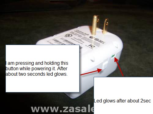

  • I had enabled permit join NLME_PermitJoiningRequest(0xff); in void zclSampleSw_Init( byte task_id )
     of zcl_samplesw file. For resetting centralite i had continuously pressed the button provided in it and held for sometime until the green status button glows while powering it. I find these kind of packets in sniffer log. I had repeated the resetting process like this twice or thrice. I don't find any association packet. I had enabled security SECURE=1 & TC_LINKKEY_JOIN. If its my own designed device then i can doubt in fw and make some changes but what i can do in these readymade
    devices. Similar thing results for hue also(hue packets not available in this sniffer log.
  • From your sniffer log, I think you don't do factory reset correctly to either centralite device or Philips hue. Unless you do factory reset correctly, they won't send beacon request and start to join your ZC.
  • I am doing following process to factory  reset.Is it correct?
  • If I remember correct, this is right steps to do factory reset to Centralite device.
  • Most of the time i reset it, i get APS packets but no association packets. In rare case new short address is assigned. What else i should try?
  • I have no idea. It should send beacon request after factory reset. If not, you should contact vender.
  • will these devices be using default security key as defined by z-stack?
  • As I know, centralite has Zigbee HA certification and it supposes using default key. The problem is that I cannot see your centralite sending beacon request.
