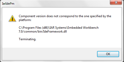

  • what to do to solve this error? error received while opening iar workbench
  • Which IAR version do you use? To build Z-Stack Home 1.2.2, you will need IAR EWARM 7.30.4.
  • IAR EWARM 7.30.4 is needed for simplink(cc2560) right? for cc2530,i am using iar version9.10.3
  • Yes, IAR ARM is for CC2538 and CC26xx. I forget you use CC2530. The formal version to build Z-Stack Home 1.2.2 is IAR EW8051 9.10.1 which can be download at www.iar.com/.../ti-wireless
  • i don't think its iar version issue. the problem comes when i start iar workbench that time the error is received and its not while opening Z-Stack Home 1.2.2 example code.
  • Yes, I know. However, I have no problem using IAR EW8051 9.10.1 download from the link so I suggest you to try it.
  • same problem exists with IAR EW8051 9.10.1 also.
  • Maybe try to remove all IAR products and reinstall to see if it works.
  • Ya, after uninstalling all iar products, error is not received.

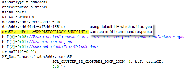

    please check again whether AF_DATA_REQUEST fn is correct or not. now error is not received in dstAddr but data is not received at zc. i have checked this by placing breakpoint in case ZCL_INCOMING_MSG: of zc.
        afAddrType_t dstAddr;
        endPointDesc_t srcEP;
        uint8 *buf;
        uint8 *transID;
        dstAddr.addr.shortAddr = 0;
        dstAddr.addrMode=afAddr16Bit;
        srcEP.endPoint=SAMPLEDOORLOCK_ENDPOINT;
        buf[0]=0x08;//Frame control:command acts across entire profile,not manufacturer 		                //specific,command sent from client to server.
        buf[1]=0x01;//transaction seq no
        buf[2]=0x01;//command identifier:Unlock door
        transID[0]=0x01;
        AF_DataRequest( &dstAddr, &srcEP,
                               ZCL_CLUSTER_ID_CLOSURES_DOOR_LOCK, 3, buf, transID,
                               AF_DEFAULT_RADIUS,0 );
    r

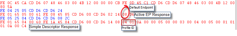

  • Do you use Packet sniffer to check if the message is sent out?
  • ya. in sniffer it shows data transmission from zed to zcafdata.psd
  • i can also read active endpoint,simple descriptor using hyperterminal. i want to check by sending data through hyperterminal.can you please tell what sample data(data field of AF_DATA_REQUEST MT Command) i should send.
  • I suggest you set a breakpoint at "if ( *msgPtr == AF_INCOMING_MSG_CMD )" statement in zcl_event_loop() of receiver side and debug it.
  • its not received in "if ( *msgPtr == AF_INCOMING_MSG_CMD )" statement in zcl_event_loop()
  • i have tested by sending AF_DATA_REQUEST MT Command from zc to zed. it hits breakpoint in case ZCL_INCOMING_MSG in zed. i will test by sending data using AF_DataRequest api from zc to zed and see if data is received at zed.
  • What is simpleDesc in your srcEP when you call AF_DataRequest? I see an unknown Profile ID in your sniffer log and I suspect this is the problem.
  • My sniffer has some problem and it often shows wrong device description like profile id,EP etc
    Here i have included Active EP Request and Response,Simple desc Request and Response. Here you can see device description are received correctly through hyper terminal.
    I will modify program to send data from zc to zed using Af_Datarequest() and check whether data is received at zed.
  • I use Ubiqua packet analyzer to check your sniffer log and see there is problem on profile ID. I also check your code and don't see you assign simple descriptor in srcEP.
  • There is a simpleDesc pointer in endPointDesc_t
    byte endPoint;
    byte *task_id;
    SimpleDescriptionFormat_t *simpleDesc;
    afNetworkLatencyReq_t latencyReq;
    } endPointDesc_t;
    I don't see you assign it in your code.
  • Ya i got now what do you want to say. Will fill corresponding fields for simpledesc and check again.
  • Yes, please try it to see if it works.
