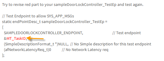

  • Try to revise red part to your sampleDoorLockController_TestEp and test again.
    // Test Endpoint to allow SYS_APP_MSGs
    static endPointDesc_t sampleDoorLockController_TestEp =
      SAMPLEDOORLOCKCONTROLLER_ENDPOINT,                                 // Test endpoint
      &MT_TaskID,
      (SimpleDescriptionFormat_t *)NULL,  // No Simple description for this test endpoint
      (afNetworkLatencyReq_t)0            // No Network Latency req
  • Now also No data received through hyper terminal except end device annce. breakpoint at if ( *msgPtr == AF_INCOMING_MSG_CMD )

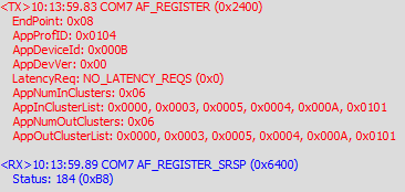

  • Try to use MT command AF_REGISTER to register endpoint from Ztool.
  • AF_REGISTER shows status as 184(0xB8)
  • Here are my transmit sequence and receive response. receiving data through uart is soul of my application. if it doesn't work then i can't do anything in my applicaion. i have tried with different sample applications of original z-stack 1.2.2 and also tried with z-stack version 1.2.1 sample application but same result i.e. no data received.

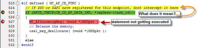

  • Hi Yikai,

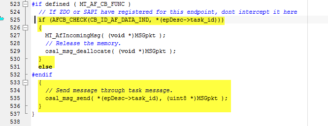

    I am debugging for not receiving data through uart. Can you please tell about the comments in the included image file.
  • I had tried commenting the lines marked yellow. After commenting these lines AF_INCOMING_MSG response is received in hyper terminal. Can you please tell what's wrong with these commented lines?
  • MT command is in hex format. Why do you try to receive it in hyper terminal? Why don't you check it in ZTool?
  • After commenting those lines only i am able to receive AF_INCOMING_MSG response in both Z-tool and hyper terminal. before i was not getting in either of two. i am testing with hyper terminal because my application in android receives data in hex format only. what's wrong with those commented lines?
  • I had added following lines
    epDesc->task_id = &MT_TaskID;
    before calling
    afBuildMSGIncoming( aff, epDesc, SrcAddress, SrcPanId, sig,nwkSeqNum, SecurityUse, timestamp, radius );
    in
    void afIncomingData( aps_FrameFormat_t *aff, zAddrType_t *SrcAddress, uint16 SrcPanId,
    NLDE_Signal_t *sig, uint8 nwkSeqNum, uint8 SecurityUse,
    uint32 timestamp, uint8 radius )
    and uncommented those lines and now i am able to receive data in z-tool and hyperterminal.
    Will it affect any thing else?

  • My problem is solved now. I had made changes as described in the document. Dono why these changes are not done in z-stack.Changes made for AF_INCOMING_MSG response.docx
  • Anyway, it is good to know you have made it worked.
  • You had told to revise following marked code. Will it not affect other operations?
  • By changing the taskID to MT_TashID, It would process the message sent to sampleDoorLockController_TestEp by MT process. Since I see no one use sampleDoorLockController_TestEp in sampleDoorLockController, I don't see it would affect other operation.

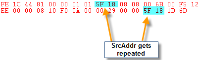

  • From MT command format, the data is 8 bytes and the byte data 0x28 after the 8 bytes of data is FCS. However, I don't know where the other bytes are from. I think it doesn't matter. You can just skip it.
  • 0x28 is not FCS but last byte is FCS. I had resetted the nwk and then checked again. what i find is SrcAddr gets repeated in the extra three bytes. i have included the response and you can find that beside SrcAddr one byte 0x1D is common in both of these response. Don't know why SrcAddr gets repeated again and where this extra byte 0x1D comes from.

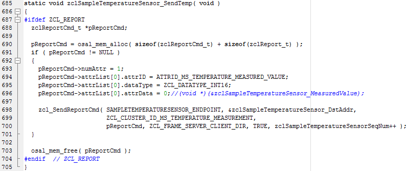

  • I am sending data through function defined for sending temperature in original z-stack. Just modified pReportCmd->attrList[0].attrData = 0; for testing AFINCOMING_MSG.
    zclSampleTemperatureSensor_DstAddr.addrMode = Addr16Bit;
    zclSampleTemperatureSensor_DstAddr.endPoint = SAMPLETHERMOSTAT_ENDPOINT;
    zclSampleTemperatureSensor_DstAddr.addr.shortAddr = 0;

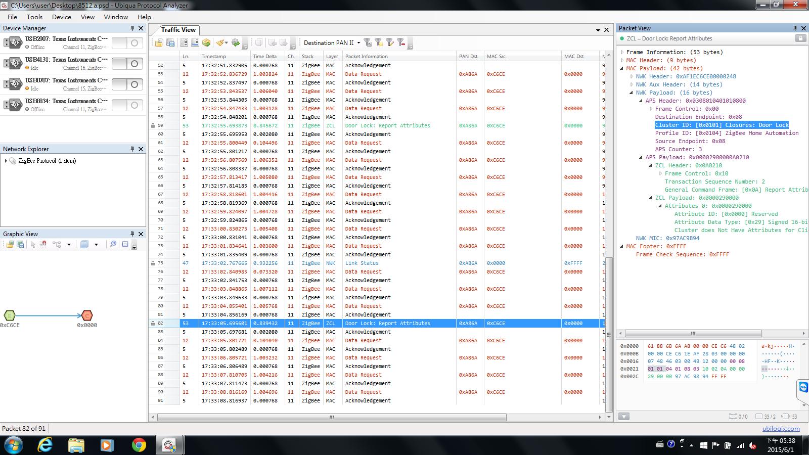

  • Can you also provide sniffer log for this message?
  • Sniffer log for data received 8512.a.psd
  • After I check the sniffer log, I don't see temperature report. There is only DoorLock report attribute. I think there must be something wrong with your code. I don't think the message is sent by the source code that you posted in previous reply.
