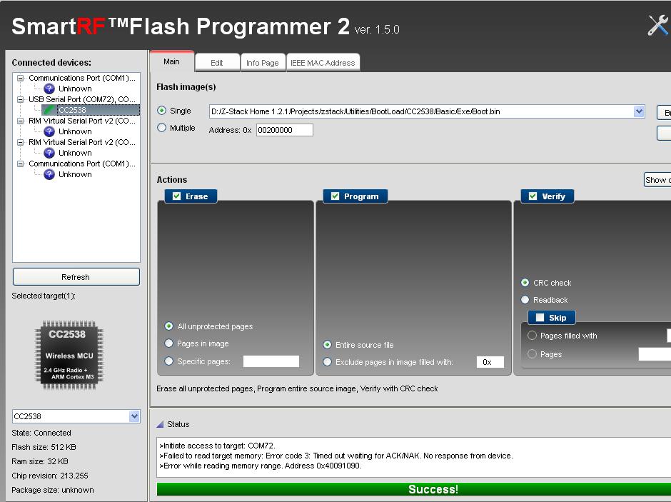

    1). SmartRF programmer, but the device (MCU) is not getting detected, tool says "Failed to read Target Memory, Error Code 3, timeout waiting for ACK/ NACK" So how is the device suppose to send the ACK/ NACk? Is it through the Custom Serial Protocol on UART0 port.

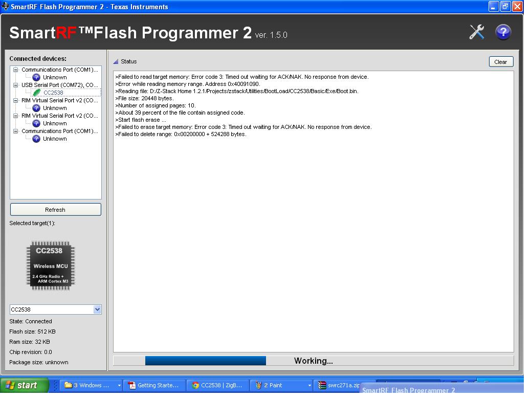

    Please find the updated details for error shown while trying to
    (A) "connect" the cc2538 chip to smart Rf programmer 2:
    (B) While programming cc2538:

    1). We are using USB to TTL converter to program from UART0 Pins (Tool is Serial boot tool/ Smart RF programmer 2).
    2). Hardware connection's at Port A, Pin PA7 is Pulled up, PA0 & PA1 are connected to TX/ RX of USB to TTL converter, rest Pins for Port A are NC.

  • I saw the same issue with a previous version of SmartRF Programmer. When I updated to version 1.6.0 (www.ti.com/.../flash-programmer) I was able to connect and erase the devices flash with no errors. Please update to version 1.6.0 of SmartRF studio 2 and let me know if it is still failing.
    TC.
