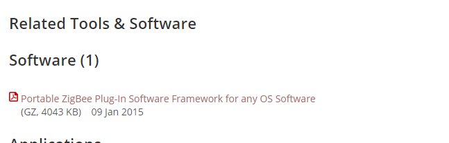

    You can download the ZNP Host Framework software and associated document from the web-page: www.ti.com/.../TIDC-ZNP-HOST-SW3. Also, you can find the software under the Related Tools and Software category on that page. Also there are various other useful document on that page.
    I don't see anywhere on that page to download software.

  • Really? A gz file? Did I mention I'm doing all my development work on a Windoze 8.1 machine with CCSv6?
  • Hi Clark,
    If you scroll down on the web-link  you should see the following section (I am pasting the image for your reference). Also, when using the ZNP host framework to make a ZigBee Gateway, since the application resides on the host application processor you should be able to implement different applications such as building automation, home automation...
  • I guess I should have known that the "GZ" meant it was something other than a PDF file, as indicated by the icon next to the link.  Stoopid me.

    I am sorry you got confused by the PDF icon alongside the link to get the software, while it is actually a compressed package containing all source code and documentation.
    Just FYI, there is no need to learn git if you don't want to: please go to https://git.ti.com/znp-host-framework/znp-host-framework/trees/master
    and then click on 'Download master as tar.gz' to get a tarball of the tip of the master branch of this repository.
