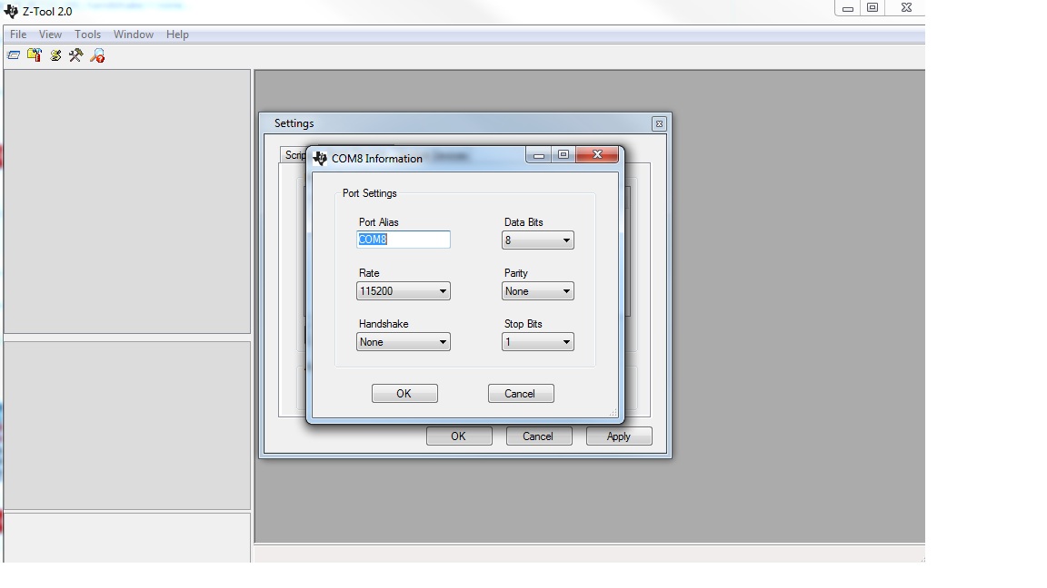

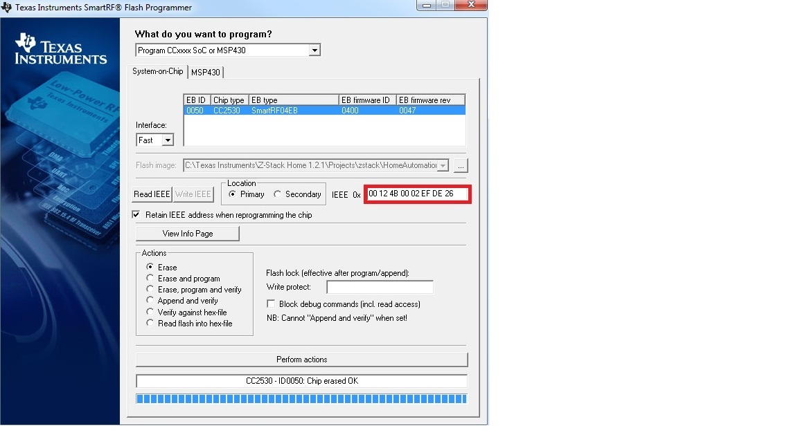

  • Hi YIKaiChen,
    1, I sure because i read it with SMARTRF04EB as image  attach
    2. I have only SmartRF04EB don't use Packet Sniffer. Can u tell me Condition of ZED to receive data ? i think sent success
    Best!
  • 1. I mean does this device joins to your coordinator's Zigbee network?
    2. ZED does polling to its parent node. If there is a data for ZED, the data would be kept on its parent node and wait for ZED to polling for it.
  • Hi YiKai Chen,
    1. I use smartrf04eb to read IEEE address on ZED(Sample SW) and On ZED i use NLME_GetShortAddr() printf  through UART
    So, it's ZED i need know Short address.

  • Have I wrong while use 2 function ZDP_NwkAddrReq and ZDP_IEEEAddrReq???
    1. With function ZDP_NwkAddrReq . i import direct from keyboard as follows:
    ZLongAddr_t Addr64bit[8] = {0x26,0xDE,0xEF,0x02,0x00,0x4B,0x12,0x00};
    strcpy((char*)&(Project_DstAddr.addr.extAddr),(char*)&Addr64bit);
    b = ZDP_NwkAddrReq(Project_DstAddr.addr.extAddr,ZDP_ADDR_REQTYPE_SINGLE,0,0);
    2. With function ZDP_IEEEAddrReq i take from case Device_annce and case Match_Desc_rsp as file attach. And use:
    ZDP_IEEEAddrReq(Project_DstAddr.addr.shortAddr,ZDP_ADDR_REQTYPE_SINGLE,0,0);

  • Hi YiKai Chen,
    I use Z tool then receive: " No devices found"
    I fix MT_UARTInit() in MT_UART.c:
    flow control = FALSE
    Baud = 115200
    use ZTOOL_P1 and
    MT_TASK
    MT_APP_FUNC
    MT_SYS_FUNC
    MT_ZDO_FUNC
    Port setting: rate 115200,handshake = none..
    I connect to device PC use CP2102 with pin P0.2, P0.3 and GND
    Please where i wrong?
  • Do you select correct baudrate on ZTOOL?
  • Yes, i choise baud 115200
