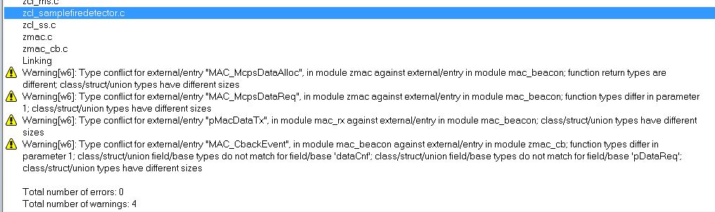

I got the IAS samples  “IAS sample code-1_2_1.zip” from TI, and there are two projects “SampleCIE” and “6683.SampleFireDetector”. I compile these two projects with IAR 8.30.2, and they show the similar warning messages as follows. When using sniffer to watch packets, after run the EZMode then I do not see the change notification by push the smartRF05 SW1 and I think it don't send the alarm to CIE.
What modification do I need to make these two IAS samples work normally?
Environment: Z-Stack 1.2.1, IAR 8.30.2, CC2530EM
  • These warnings seem come from mismatching API call with Z-Stack Home 1.2.1. Where do you download IAS sample code-1_2_1.zip?
  • Hi TI, any suggestion or help?
    Hi YiKai, this zip file is a source code for http://processors.wiki.ti.com/index.php/Fire_Alarm_System.
  • There is already no link to download the fire alarm source code from  and I believe the source code you downloaded has to work with old Z-Stack version. So, which Z-Stack version do you use?

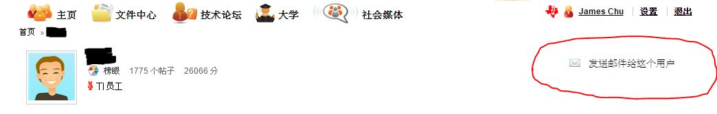

  • I don't have the source files. Maybe you can attach it and I will try.
  • Hi YK,
    I am not sure whether I can attach this IAS sample on public forum or not since TI do not have download link on web site. Can I mail to you in private like TI e2e forum in China? But I do not find the same function on this forum.
  • Maybe you can request to be my friend on E2E forum and attach source code in private message.
  • I see the same warning in my test. You can disable FEATURE_GREEN_POWER in compile option to solve it.
  • Hi YK,
    Can you tell me how do you know to disable "FEATURE_GREEN_POWER" option to avoid the 4 warning messages?
    There are 6 FEATURE_GREEN_POWER define, and I do not see the relationship with MAC_McpsDataAlloc, MAC_McpsDataReq, pMacDataTx and MAC_CbackEvent.
  • It's my experiences told me that. Ha!

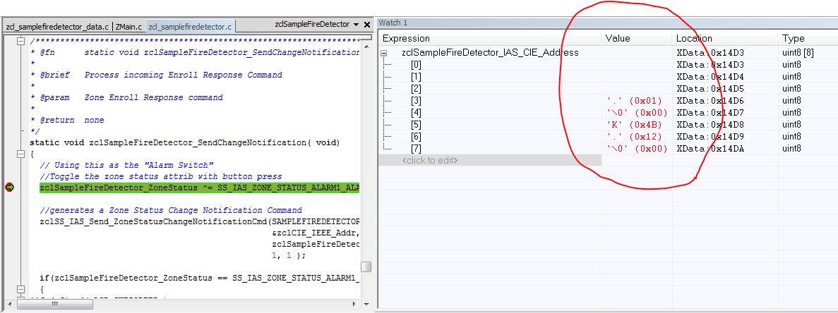

    If I use this IAS sample with z-stack 1.2.2 and IAR 9.10.3, then the FireDetector's  IAS CIE address attribute cannot get the full 8 byte IEEE address.
    Only write the first 5 byte successfully.
    Can you help to check it?
    I test it's ok in zstack 1.2.1.
  • According to " 如何感知zcl_sendwrite()http://w244627.s117-18.myverydz.com/thread-2118-1-1.html"
    I change CIE address attribute to NULL, and add the callback function zcl_GetReadWriteCB(uint16 clusterId, uint16 attrId, uint8 oper,uint8 *pValue,uint16 *pLen); to debug.
    When I dump the CIE address value, it seems receive correctly.
    So why write CIE address attribute command got the wrong value, do I do anything wrong?
  • Is it possible that write CIE address attribute is not correctly sent to your device?
  • I got what happen,  write CIE IEEE address attribute is success.
    But I need to change IAR watch type to display the correct value.
