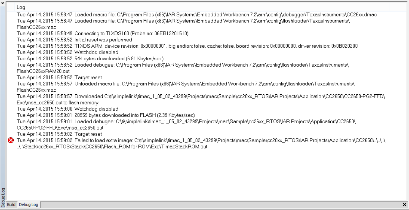

I'm trying to run the example msa_cc2650 - FFD application explained in the MAC User's Guide. With some assistance from Suyash(e2e.ti.com/.../1479691) I'm now able to build the software but now, every time I attempt to Download the software I get the following error:
The Debug Log shows:
Anyone have any suggestions to debug and resolve? I am attempting the run the default example using IAR for ARM v7.40.2.8570. I have TI MAC 1.5.2.43299 and TI RTOS 2.11.1.9.

    This is most likely because the example applications are set up to load debug info from the stack project .out (ELF) file (Options->Debugger->Images). When you haven't built this in advance the .out file will not exist.
    Typically you need to build and download the stack image first and then download the application afterwards.

    For this issue - I have a question, what version of IAR are you using? From the figure above it looks like you are using 7.20? The version of IAR with which TIMAC Sample application were tested as mentioned in the Readme.txt file (at C:\ti\simplelink\timac_1_05_02_43299 ) is : CC26xx + SRF06EB: EWARM 7.40.1. If not using 7.40.1 version, can you try testing with this version of IAR.
    The file TIMACStackROM.out should be generated when you build the stack project. You can also try to rebuild the stack project and see if that resolves this issue.
    Also, if you were not using the IAR ARM 7.40.1 version, I will recommend re-installing the TIMAC before you try to build and download the application to CC2650/30.
