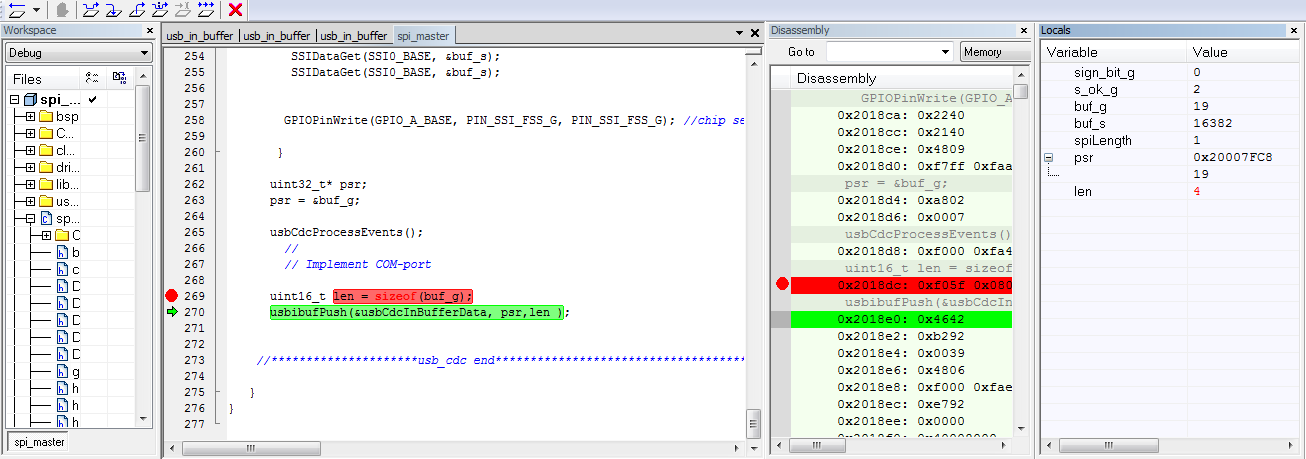

  • Hello TheDarkSide,
    You are totally right to get rid of loop-back programming.
    I have changed  my code:
          uint32_t* psr;
          psr = &buf_g;
          usbCdcProcessEvents();
            // Implement COM-port
          uint16_t len = sizeof(buf_g);
          usbibufPush(&usbCdcInBufferData, psr,len );
    I am wandering why I cannot get the data from  terminal.
    The following figure shows the debug results, and I can get the data (buf_g) from sensor.
    The function that I want to perform is sending sensor data (buf_g) to PC terminal through USB CDC interface.
    did you make sure that the CC2538EM board gets enumerated on your PC and appears as COM port?
    Please verify this first. Your PC must be connected to the micro-USB port of the EM, and the jumper on the EM should be set on the vertical high position, connecting the VDD and the USB power pins.
    Then connect your terminal to that UART port.
    TheDarkSide
    Yes, the CC2538EM has been connected correctly and I can get the COM port. Also, the signal tested by oscilloscope at pin MISO is good
    I am not sure why I cannot send the data to PC.
    I am wandering whether the function usbibufPush can send uint32_t buf_g to terminal.
  • How are you interpreting the data on the terminal? The data will be sent as is, so if your terminal is supposed to receive ASCII code then you would not see anything if for instance you write buf_g value is decimal 19.
    Please also note, the way you are pushing data to the terminal is probably not correct. You want to push 4 bytes (since buf_g is 32 bit) but psr is a 32 bit pointer. In order to avoid 32 bit increments, you would need at least to force the casting of that pointer to a uint8_t* when passing psr as an argument in usbibufPush().
    TheDarkSide
