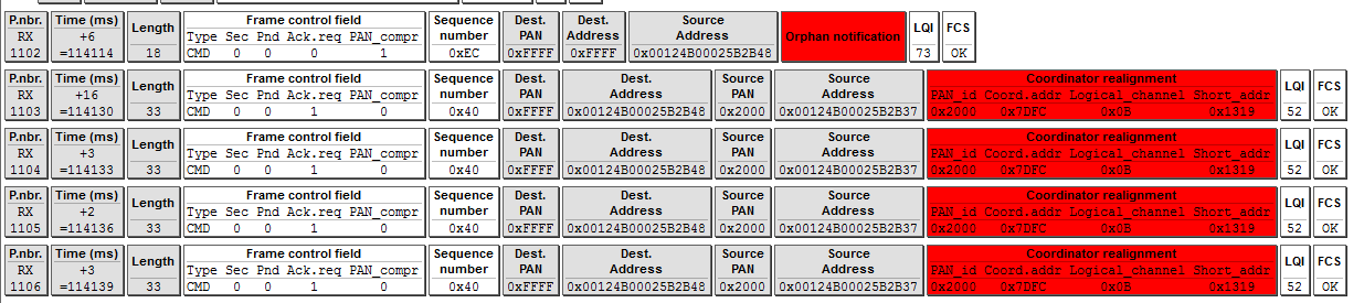

Hi Ti,
I am seeing some type packets as shown in below in the network using packet sniffer .what is the meaning of such type of packets?
Dear Darkside
in which type of scenarios the realignment frame generates?
what is the use of that realignment frame?
is the coordinator/router received the orphan notification or not?
Dear Darkside
Thank you for your valuable information regarding the end device orphan notification.
from your reply i thought that zigbee end devices send polling frame periodically to their parent after checking the channel is free or not.so in that context CSMA-CA is used.
is that right or wrong?
